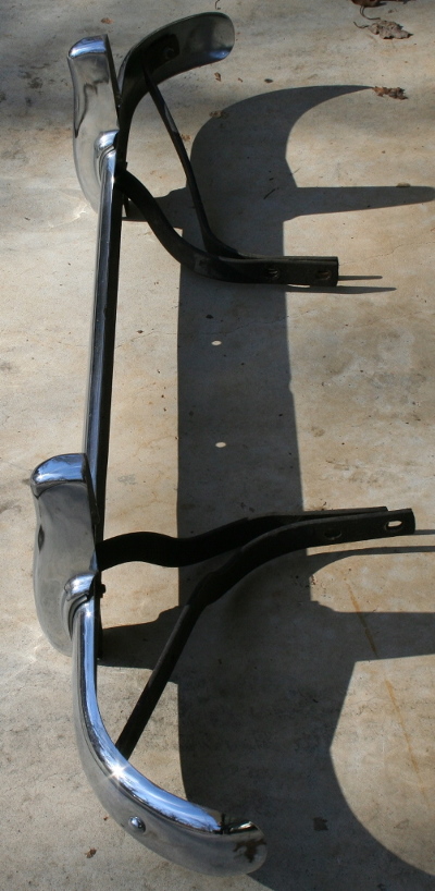

ncbugeye
I just happen to have my front bumper removed right now, so I may be able to help you with pictures. To start off, here is a picture of the bumper with its 4 brackets. Tell me exactly what aspects you want more detail on, and I'll upload more pictures.

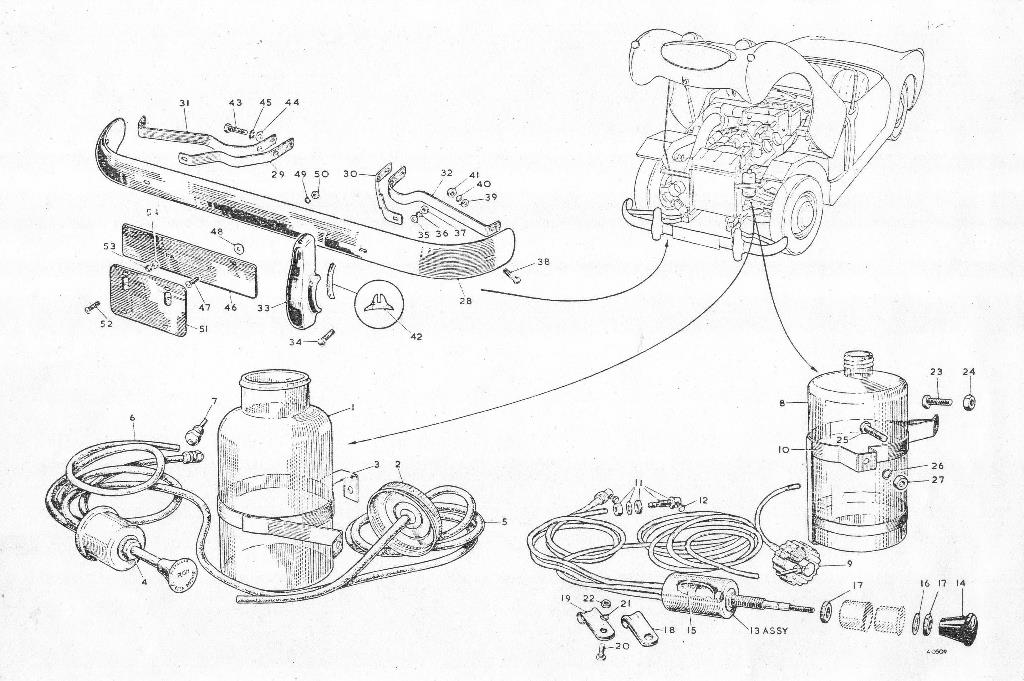

ncbugeye
Here is the service parts manual page
