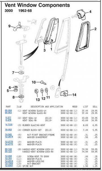

I am talking about part number 4 (18-082) in this Victoria-British catalog picture. Not sure what the BJ7s used.

Hi Gearhead Glen, Right, I have the part you've identified. The part I'm attempting to find is not shown in this catalog. It is shown in the Moss catalog but they don't give it a Moss number apparently because it is unavailable through them. They do give it item number 144 (next to the window Sealing Rubber) on their drawing here:

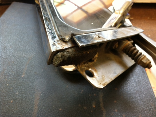

Dan, here is a picture of the vent window frame from my BJ8. I don't see any piece like that. There is the one piece rubber surround, and a rectangular piece of foam along the bottom of the frame. I imagine that the one-piece surround does the trick.
healeydan
healeydan
Hi CLEAH, ding ding ding, you are the winner. That is exactly the item in question. Initially I assumed (and we all know the effects of doing that) it was a molded rubber part but that is not the case. As your photo shows, (and as it was explained to me today by a local Healey guy) it is simply a piece of foam who's purpose is to block the flow of air through the void under the wing frame. Thank you for the show and tell.
