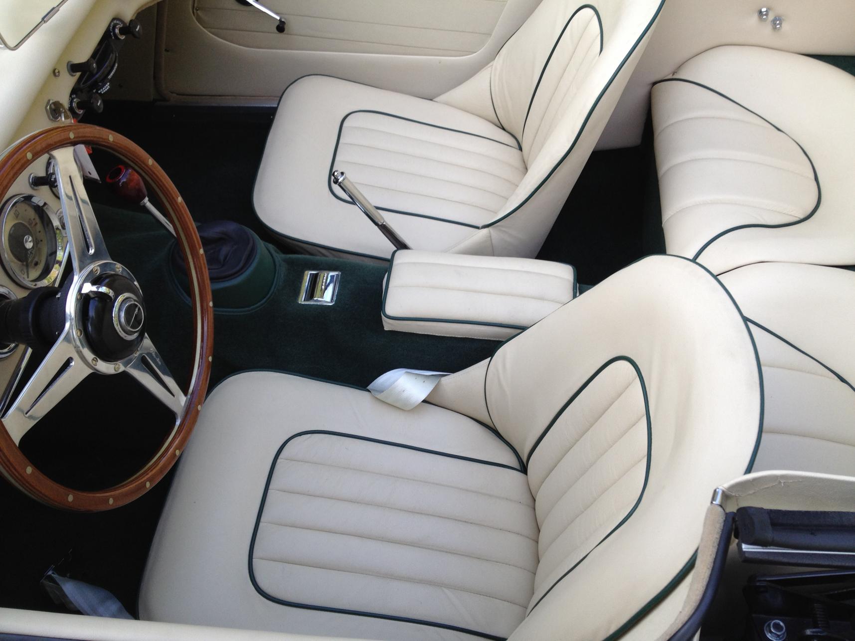

They sent me samples to choose from too but I'm waiting to get the actual interior to see how the match is. I believe my interior might be the same color as yours, before ordering a Boot or Tonneau cover. Top is staying black.
richberman
I sent them samples of my cinnamon and green interior and they matched it spot on! I didn't care for the boot armacord so I stuck with black like Abingdon built cars.

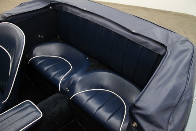

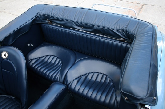

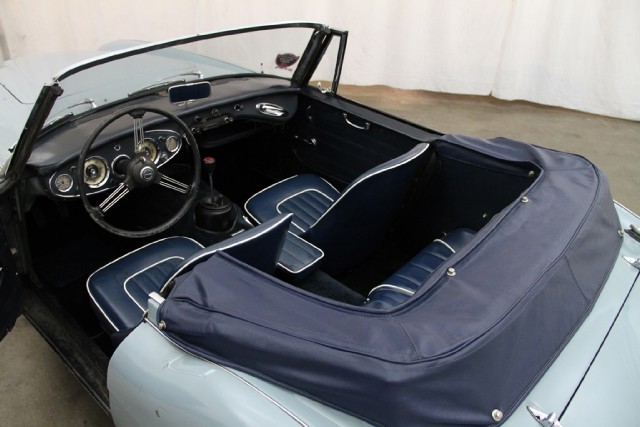

I think the BJ8 boot is a little more tailored than the BJ7. I think there are more visible Lift-the-dot fasteners & snaps on the BJ7 boot, but not 100% certain of this, just observation of photos. I don't have a Healey restoration guide to refer to. Does anyone know if the BJ7 boot should have all those fasteners? Robert, is yours like in this pic of a BJ7 I've attached? If this is how mine should be attached, then I've got a lot of studs and snaps to install. The Robbins black Everflex boot that came with the car never got fitted so I've got to examine the fasteners they included and be guided accordingly. I found a vinyl supplier that sent me samples which match quite well. Even though I have a black top, it rarely goes up because if the weather isn't nice, I don't take the car out, so I'd just as soon hide it with a boot that matches my interior. It won't be "correct" but the colors on my car aren't correct for a BJ7, anyway.
Correction: Robert, if yours is a BJ8, then yours should look like the first photo. The 2nd photo is from a BJ7. Not sure if it's correct, though. Anyone know?
I think that you are pretty much spot on with the BJ7 from what I have discovered. There are two on the out side at the back, then there is one each side on the outside near the front of course. I have installed the two on the top but the inside ones and the end ones are not there yet - no interior panel fitted yet.

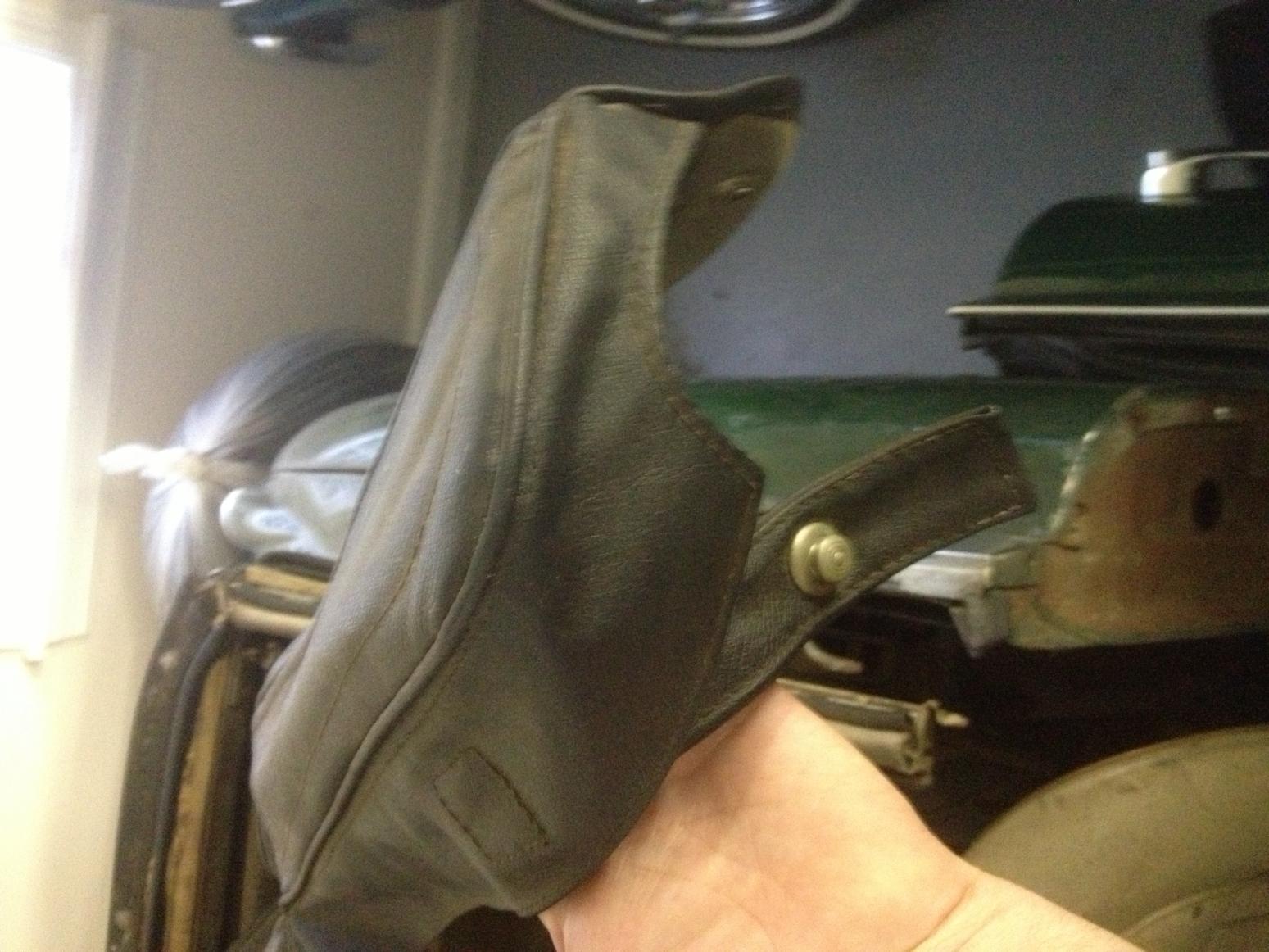

Bob,
Yes, my BJ8 is like the first photo, with the exception of the front, inside lift-the-dot fastener that attaches to the interior panel is actually attached to a strap which is sewn on to the inside of the cover. Photo is the driver's side of the cover. You can see the stitching in the form of a square. My father bought both of my cars in the mid seventies. Can't be certain, but think this cover is original to one of them. FWIW.

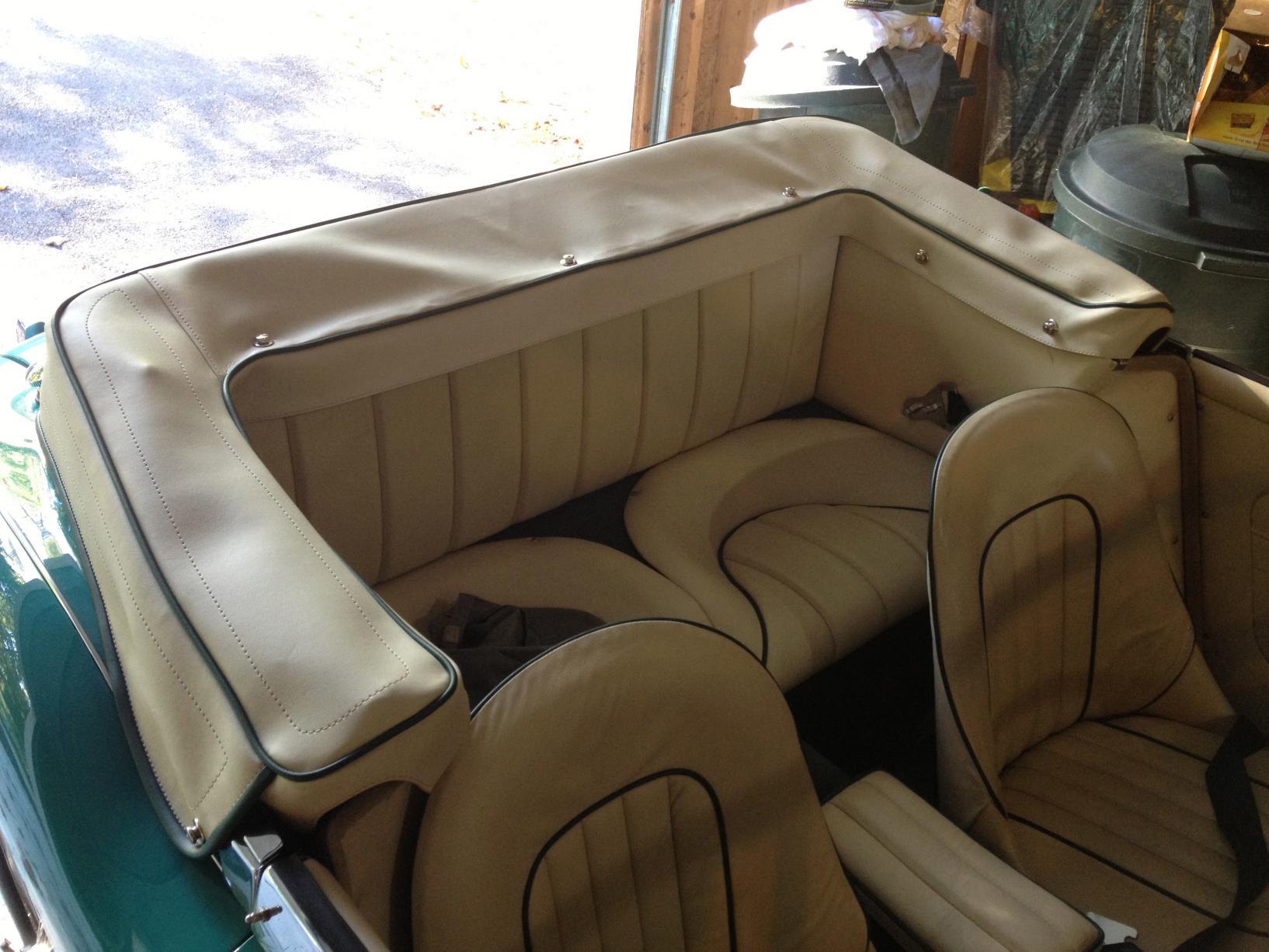

Ta-da! I think it came out great! It took a lot of ordering of samples to find a close match but finally located the piece goods and found a custom upholsterer a 2-hours' drive away and had to sacrifice my unused Robbins boot to make the pattern but he did a masterful job, IMO. Overall cost came out similar to what Heritage charges but they couldn't match the interior, insisting that regular vinyl wouldn't work and only Everflex would. Proved Bart wrong because my guy made what I think is a masterpiece.

Nice color choice Bob. My BJ7 has metal interior ,side front, panels on each side with a hole at the top presumably for the lift-the-dot fastener. Most I've seen put the fastener on the inside side panel, due to rubbing when entering. I have two mounted on the rear seat back, plus the 4 on the outside for a total of 8 altogether.
