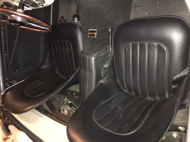

There's nothing about British upholstery that requires particular expertise; esp. if the shop has an original or kit to go by. I had my BN2 seats--Moss kit--done by an 80+ YO man in San Jose who said he'd started in the business at 13 when his father took ill. I was encouraged by the fact he had several exotics in his shop when I visited. He did say they were a PITA, esp. the seat bottoms as the foam required lots of shaping. On the seat backs, the part by the lumbar where there's a seam is sometimes done poorly, with looseness and/or too much wrinkling. He charged me $500 and it was well worth it.

60 plus years of experience! I'd hire him too. The prideful examples posted by my local guys, of simple USA cars, didn't give the warm fuzzy feeling I need to hire them. If I want it 3rd rate - I can do that myself for free - and I might need to. Interesting that some folks reference the seat bottoms as awful and others the seat backs as the challenge. Bob, I'm encouraged by your estimate that it's a do-able project. Although, when working on checking the rust through on my inner boot panels, I had trouble straightening up and backing out. Pretty sure I used to be more bendy.
In looking at various photos of car interiors, floppy saggy upholstery is noticeable. My 60 year old seats look better than some I've seen, which is concerning in going forward. My town has less than 6,000 people and the entire county less than 13,000 and we're the big dogs in a 4 county area. The only upholstery guy works out of his garage as a hobby income. I be afraid - very afraid. I'd be thrilled to have a completed project that looks like the seats in your photo. I bought Moss's upholstery video, which I'm reviewing now. Anyone do that - did it help?

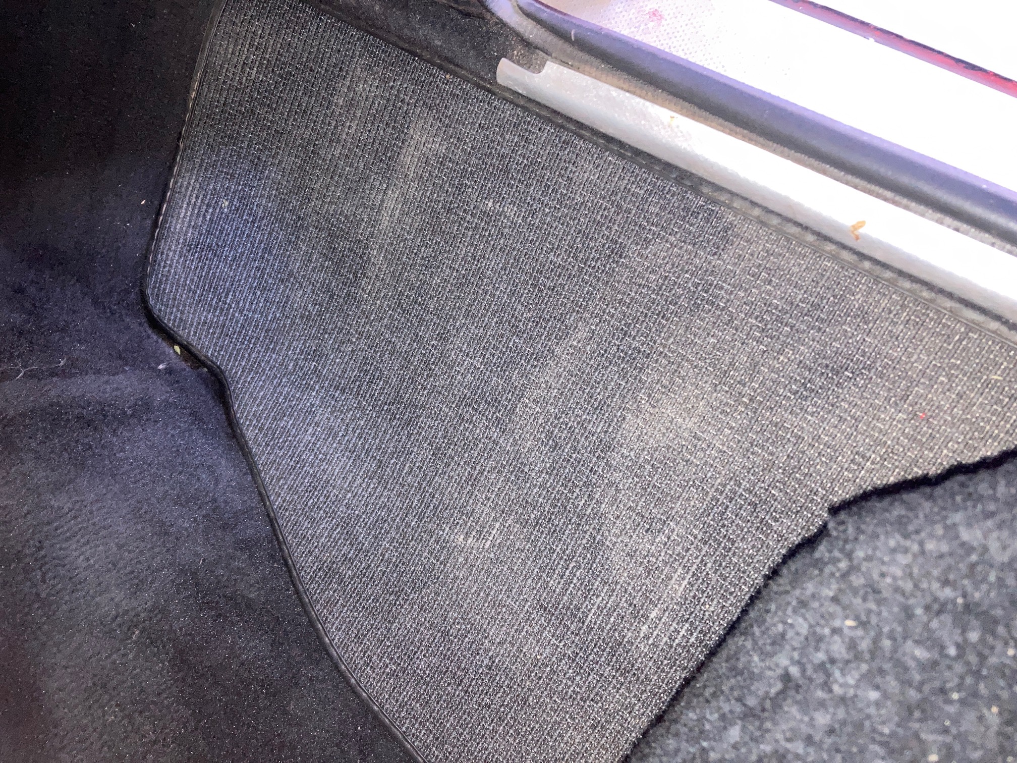

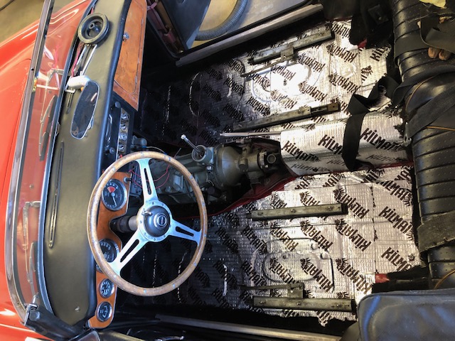

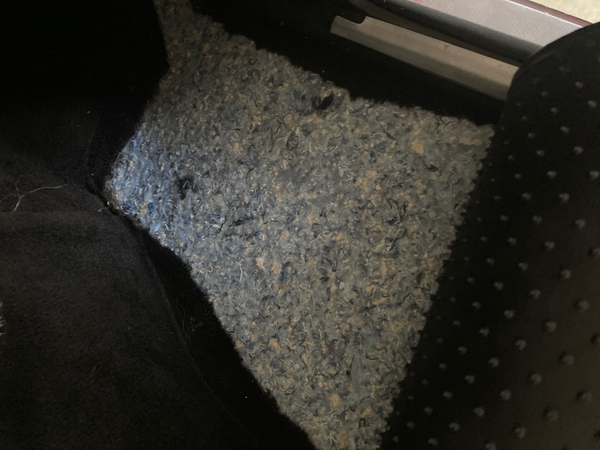

Bob, the carpet looks like a recent re-do. Did you use any sound insulation or heat shield? If so - any advice?
Depends how original you want to be. Originally, I think all the cars had a tar paper over paint, with jute padding then the carpet. On the BN2, I got the kit from Moss, which came with a thick pad, and just laid it down. It's not likely this car will see much rain; we put down lots of paint and I can add something later (1st photo). For the BJ8, a few years ago I scraped out the tar paper and installed Kilmat, a Russian(!) made knock-off of Dynamat (2nd photo), then put a layer of shredded cloth water heater insulation over it (3rd photo). Then, I had floor mats custom-made by Cocomats, which are da bomb (4th photo). The floorboards will get wet, some way, somehow, so it's arguably best to have carpets, etc. removable (there originally was 'Lift-A-Dot,' I think, fasteners). I'm comfortable that the Kilmat makes as least a good a seal as tar paper, and the cloth insulation will dry but probably not as quickly as jute. Dyna/KilMat helps with soundproofing, but not much with heat insulation. My cars are drivers, esp. the BJ8 which has somewhere around 210K miles. My BN2 is a factory 100M which my late father and I restored but it's not near concours quality, but it's fun to drive. The BJ8 still has the carpet that came with it; apparently an aftermarket kit of something done by an uphosterer. Not fancy but does the job.
One unusual thing I did for the BN2 was put a layer of a 'bubble-wrap' kind of insulation with a foil side inside the doors, followed by leather. The roadsters have 'hollow' doors and I think, originally all they had was with a layer of vinyl or leather--however they were fitted--and would make a hollow sound when closed. When I close the doors on that car they make a very satisfying, meaty 'thunk.' The Moss carpeting kit was OK, not great, with some parts of the boot lining not cut exactly right.

Perfect. The car had cheap carpet replacement with nothing between floor and carpet - so nothing as a guide. While sound block would be ok, the heat through the floor, in winter, is a plus but my side of Colorado has 100 plus summers. I've ordered a velour carpet set from Germany that is more complete than most. Always difficult ordering from a 2s2 catalog photo. It comes with the oem type snaps, that can be used, which puzzles me on how to apply to floor side if I add too much padding. Clearly the snaps allow removal to dry if a puddles are actually holes. Really - if the pipes drain water out do they also pipe in?
Related. KoolMat looks to be the optimum liner for heat rejection (I haven't used it):
