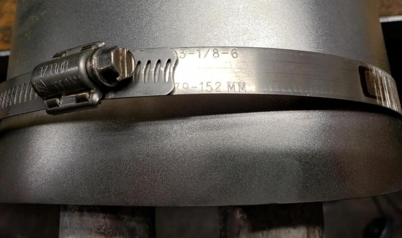

Yes, putting a clamp on the muffler would change its resonant frequency and could work to quiet it down. What kind of clamp would you recommend, Keoke? The restricted space around the muffler would require some kind of band clamp, but the muffler is 13 inches in circumference. That's a hefty clamp!
steveg
The roadster muffler is 17" around - I had no trouble buying this size clamp at the hardware store:

I tried at least 5 of the above clamps on the loud muffler and they didn't make any difference in the loudness. I did not, however, have a loose baffle.

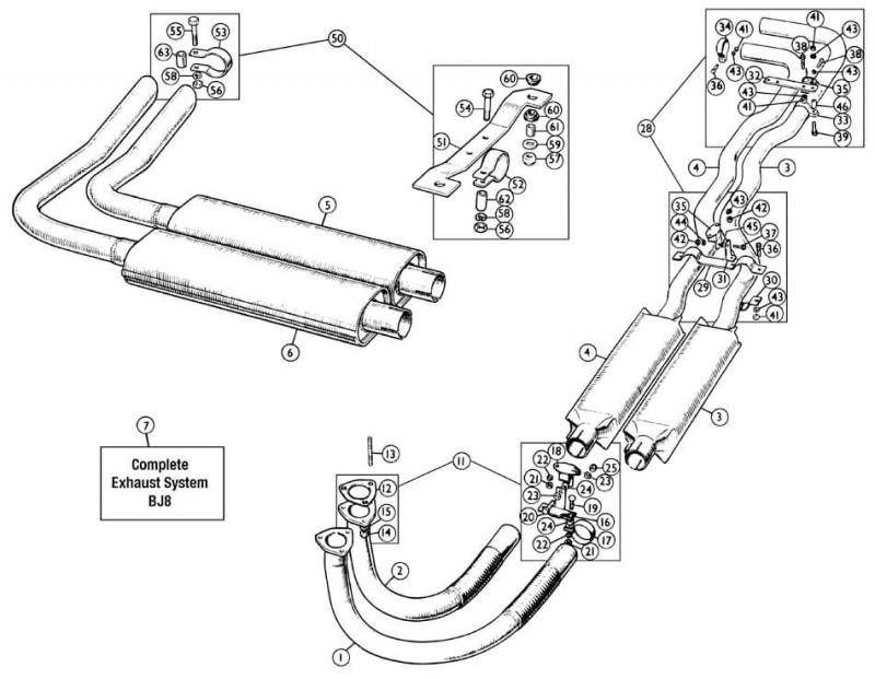

Here's a photo from Moss's catalog that shows what I believe the original front silencers looked like. #4

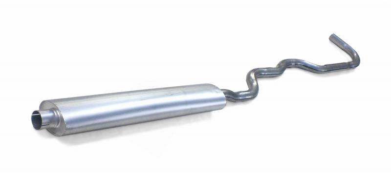

Here's a photo from AHSpares. Doesn't appear to be as the originals. Looks like what moss and other vendors sells, simple oval shape.

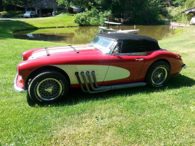

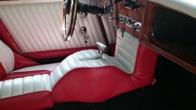

Anyone looking for a slightly modified Healey? Owner seems to like the cove's of the Corvett vs Healey. Check out the center console too. More mods, I dare you to click on the link.
1967 Austin Healey 3000
Running driving car, 289 ford motor (runs good but is tired)C4 automatic trans, top chopped 3",seats lowered through the floor 3", custom tuck and roll interior, front wheels widen 1" and rear wheels widen 2", have original grill and some chrome pieces that will come with the car. Some minor paint chipping, headers need to be painted. Small exhaust leak from 1/8 inch hole in pipe. The taillights have a break in the line but work with rerouted line. Solid car, owned for 30 yearsby owner who did all the work.
C3723DCD-FE20-42DE-BC2E-6A78C7F63A7F.jpegA5C024B1-49CC-4CA2-9911-DAACD21F77C8_4_5005_c.jpeg
https://mfpclassiccars.com/austin-healey/53010-1967-austin-healey-mk3-modified.html
Healey Nut
OMG thats horrific !!!!!!!!!!
