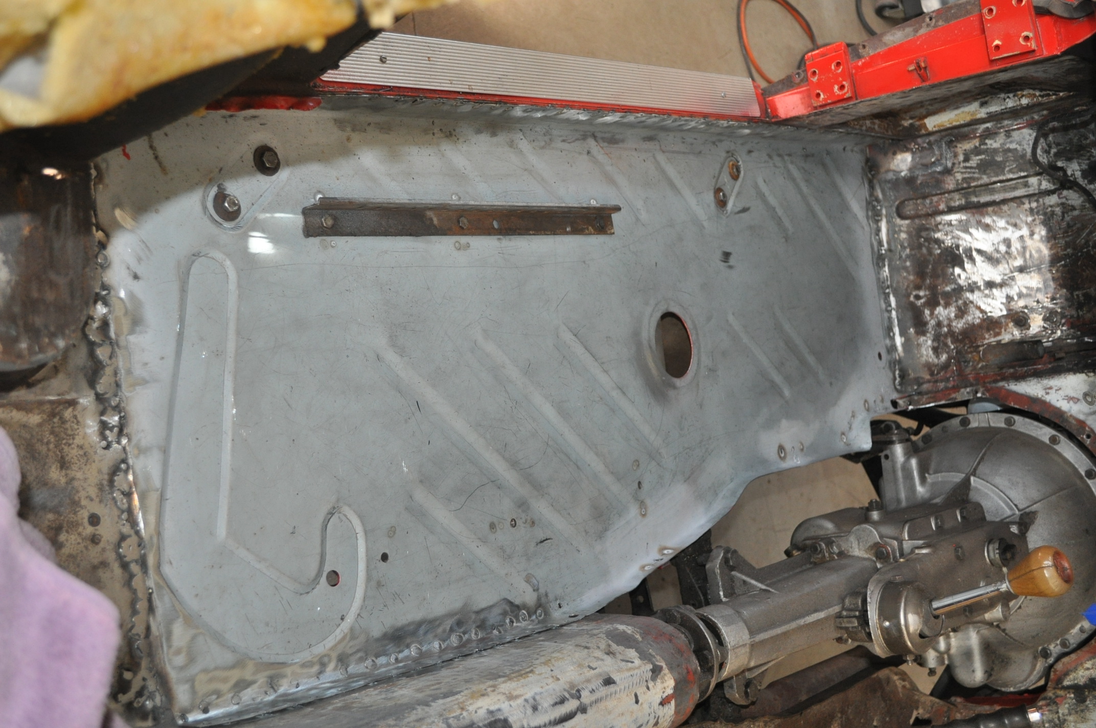

ront. Trimmed it several times before it got too short, only kidding. You probably already pried up the side strip rear of the door, a must for getting it in. It has to slip under the strip and under the back floor piece first then forced down in the front. As to width mine just forced the tunnel over with no bad results. The side by the door opening was too tall and also had to be ground down flush. Here are a couple of pics.

Thanks for the pics.... they always help. Sounds like a little trimming, re-fitting, trimming more and taking the time to do it right is the key. No need to rush it right? I will be making sure that the bolt holes line up with the inner sill mounting flanges too. I'm hoping to get a little garage time in today 😎

David... too late. I bumped my head on that sucker already! Thankfully no gash or bruising. I'll have to remember that when I do the other side. I was able to get it in there and fitting nicely over the weekend.
