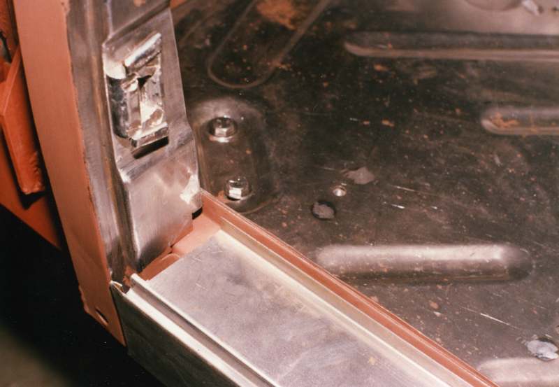

Re: `57 TR3 Small Mouth on ebay: Really, Really N
I had to curve the outer sills about 1/4" from front to back and about 1/8" from top to bottom. If you don't, the repro sills will be flush at the front and back where they mate the A & B posts, but in the center under the middle of the door, the sill will be 1/8" or so inside the bottom edge of the door.
Another way you might correct the curve is to add 1/4" of Bondo to the sill half way along.
The repro outer sills and bent on a modern brake press set at 90 degrees all the way. That's why they are straight. The original silles were pressed in tooling dies that resulted in the correct shape.
In fact, setting the brake at 90 degrees actually gives the sill a 85 to 90 degree bend and the top as well as the outer face actually come concave - not flat from top to bottom.
The front cut-away to clear the front bottom corner of the door when you open it wide is not enough and you may bend the corner of the door if it is not corrected. The rear ends of the outer sill are made about 1/2" to 5/8" too short and you have to MIG in a small piece of sheetmetal to close it.

Don,
I will never look at a TR in the same way again. I never knew about the differences with the repro sills. I had heard that the top of the repro wings is the wrong shape but didn't know about the rear of the wings. It is very obvious in those pictures though. Now I will be looking at all the early TRs on eBay to see if I can spot the repro panels!

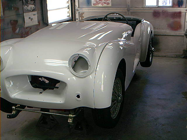

...a 57 TR3,factory sills,doors, fenders...some day I'll finish it, altho not to spec.
Hi There BOXoROCKS,
Really nice looking TR you have there!
I like the "Louvres" in the hood and simply everything about the car!
Hope you get to finish her soon! If not please contact myself and maybe, Just maybe I`d be able to finish her?
