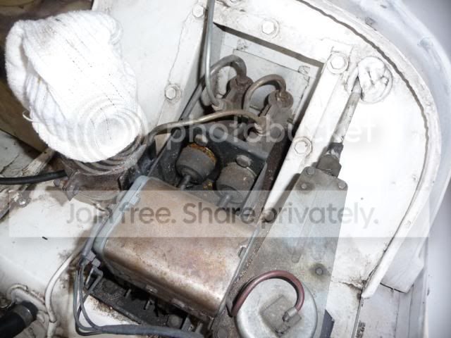

I noticed the TR4a (yes Randy, I'm nudging her forward rather than giving up) M/C where leaking a bit so I pulled them. Look at all the crystallized brake fluid that crumbled out of the seals by the time I was done removing them;
Keep the Nissan M/C just to be different - ha!

Hey Tom,
I am looking at the same kinda thing on my 3
Pretty crusty around the seals....
Cheers,
M. Pied Lourd
Brosky
Looks like a bit of flushing and caliper/cylinder rebuilding is in order.
Better now than after the brakes go to the floor on a panic stop.

Yeah, that looks like it needs a little work! So that's a Nissan clutch m/c? Do the mounts line up well, or were they persuaded a bit?

It actually lines up surprisingly well. There were a TON of washers in how they bolted it down, but if you didn't know better you'd say it was supposed to fit.
