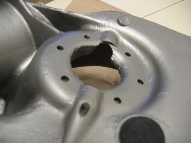

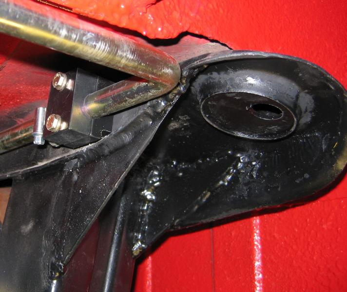

I did see in the introduction where mention of additional loads in to the upper spring pan are made. These additional loads were why the Revington kit adds the two gussets from the uprights/vertical towers extending outward toward the upper spring pan for each side. I was somewhat surprised to see carriage bolts swaged into place on the control arm for the lower mount. I do like the bar mounts of the Ratco kit better than the mounts that came with the Revington kit. I wound up scrapping the Revington kit ones and made up some solid mounts with a heat cured molybdenum disulfide solid film lubricant finish applied to the bearing surface.
The Revington kit uses a sandwich plate arrangement for the lower mount with that end of the damper in a double bolt shear configuration as opposed to a pin mount. Upper mount is a pin mount set up similar to the Ratco kit. Attached are a couple of shots, one showing the welded in gussets and upper mount plate, the other shows the modified trailing arm with six satellite holes for the sandwich plate set up and what turned out to be perhaps the most difficult aspect of the project to get right, the damper adjustment access hole. It is that hole along that raised and tapered rib. Lots of time expended figuring out how to approach the task without making a mess of things, but it lines up perfectly with the damper adjustment screw, just had to then make sure and orient the spring in a manner that a coil did not block the adjuster on assembly.
