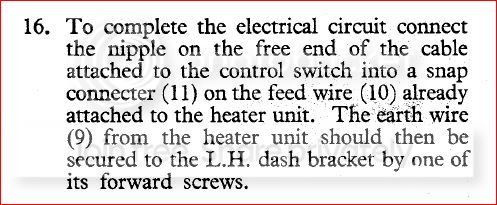

here's a diagram from the owner's manual that shows two wires landing on the panel grounding terminal; one going to the control box ground and the other to one side of the wiper switch.
The number of wires is not critical. IIRC, I added a couple and looped them to other points where I wanted to improve the ground integrity.
Tinkerman
On my TR3A the wiring diagram shows 3 wires on the grounding lug. So that's how I wired it up. A bit of a tight fit as I recall.
Tinkerman
Geo Hahn
I think, too, that there are ground wires that were omitted from the diagram for simplicity, e.g. the ground harness that goes to the speedo and tach.
V
vicno
Thanks for the replies. The car was in pieces when I bought it and it's hard to remember where everything goes. Here's another question. Where does the ground wire for the fan motor attach?
6TTR3A
When I took my 3 apart, the heater fan ground wire was attached to the heater mounting bracket stud that went through the firewall. Since "Miss Moneypenny" came from the factory with a heater, I assumed that's where the ground wire belonged
