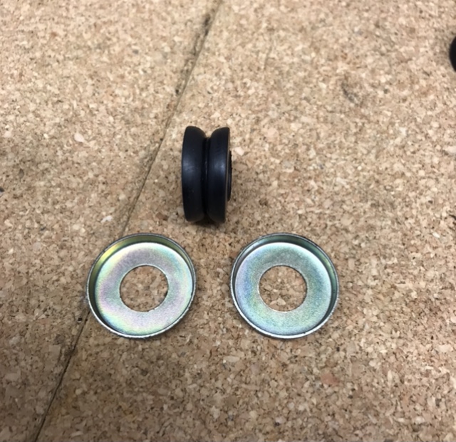

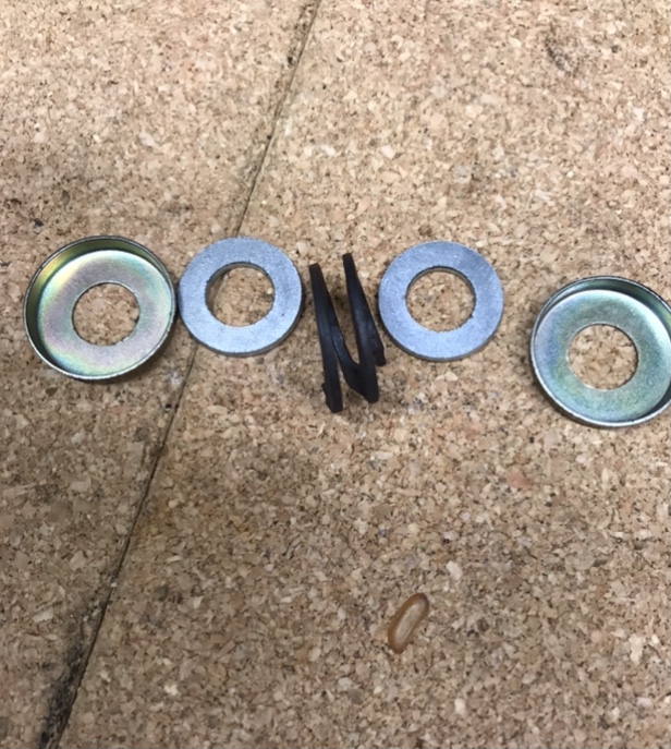

What was the cause of the fire and was it related to running the fuel line near the firewall rather than the stock location?
Hamish Racing
Hamish Racing
Hi karl
No nothing to do with fuel pumps or pipes or routing.
it was a leak between Weber and manifold on the flexible gaskets. And I think this was due to over fuelling and the nature of the course
Here you go from flat out on an uphill curve suddenly shutting off power on a tight right hander and no slowing down over time and distance to settle things. I think this floods the carb Venturi intakes. And it just weeps out of the join. And with our cars they sit above the exhaust.
I have redone the misab flexi washer spacers from rubber to springs.
float height checked. And road tested all good
