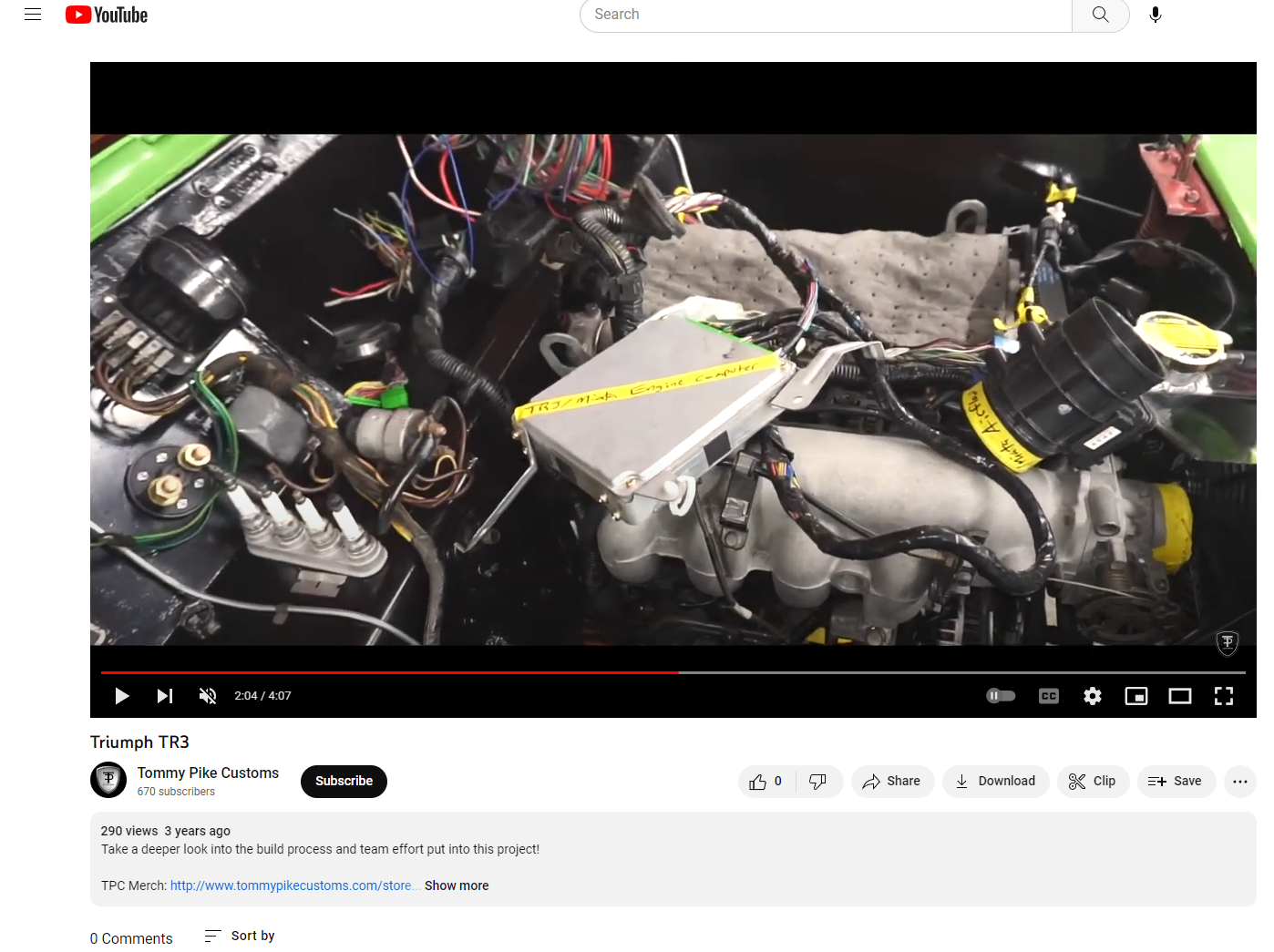

TP seems to keep the details under wrap (as well as the car).

Did I watch the wrong video? I'm seeing a Miata engine (or at least a DOHC 4-cylinder with an ECU labeled "TR3/Miata Engine Computer").
The criss-cross pattern on the side of the head looks Miata-ish to me. That would also explain why they have a single 4-plug holder.

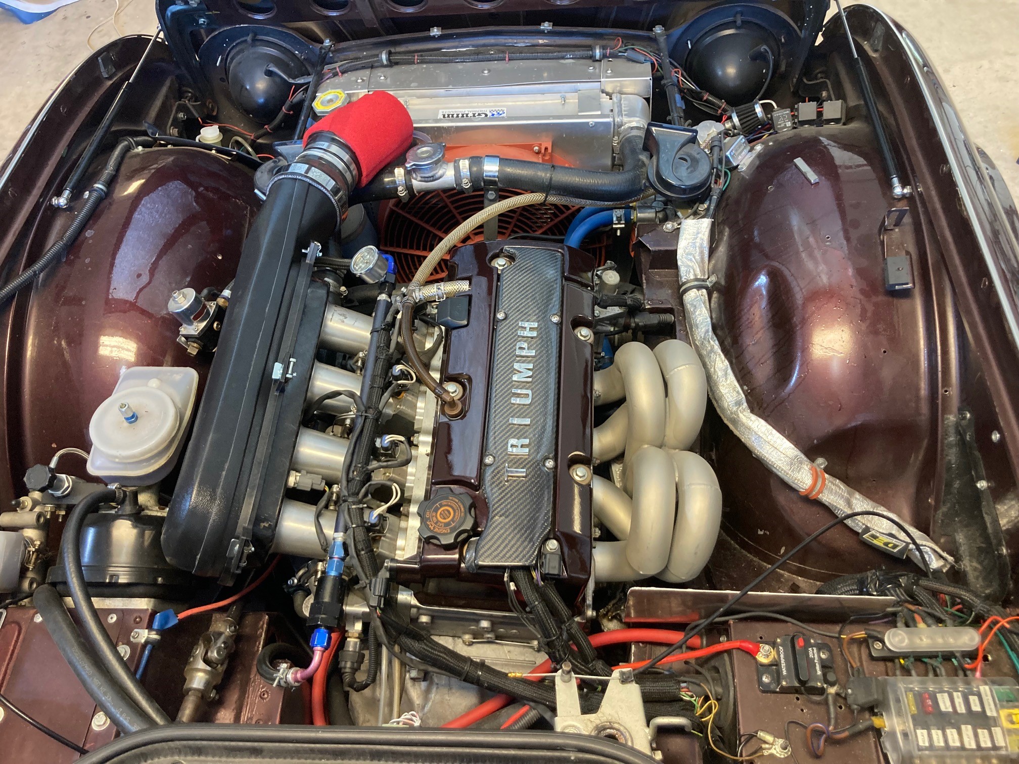

There are a lot of nice Japanese engines that will fit into our cars. I had a '58 Big Healy in the early '80s with a 302 Chev Z28 motor and a 4 speed, it just burned tires up.
Now I've got a TR4 with a Honda S2000 engine that puts out around 250hp. It is a fairly low torque, but high revving engine so it feels just right
