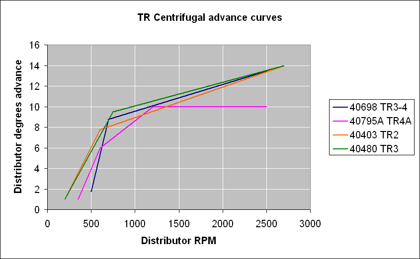

Sarastro
Here's what I have:
I don't remember where this came from, but it agrees with other info I have seen.
This shows that 16 degrees is a bit high for the TR2-4, but remember that there is at least +-1 degree of tolerance on these curves.
TFB
I wonder why the max advance for the tr4a is so different from the others at only 20 degrees.
Are the cams that much different?
