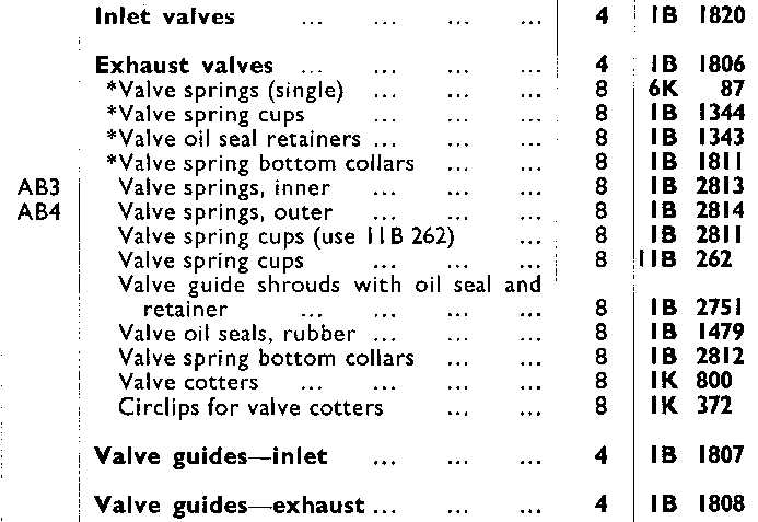

The bleeding obvious first; are the stems old/new same diam?
