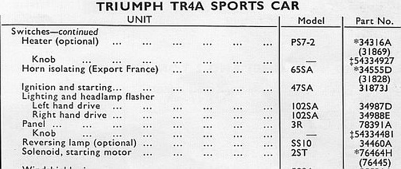

Oddly enough, though, it appears that the Stanpart number did not change. My TR250 SPC has only one number for the solenoid itself (121269, same as earlier TRs) but lists two different sets of hardware, one for Model 2ST and one for Model 4ST.
Andrew Mace
Doesn't surprise me at all, Randall! OTOH, the Lucas part numbers went back and forth over the years on the 2ST model (and not just that suffix letter). It's also worth noting that there were at least two distinctive styles of the 2ST, with earlier ones having more or less cast "feet" and the later ones having a simpler sheet metal mounting bracket. That change occurred around 1959-60!

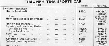

Wouldn't be the first time the documentation didn't match the cars, for sure.
But I did the same thing Andy did (I think), and checked the Lucas catalogs. The 1967 catalog still shows the 2ST (with different part numbers as noted).

Andrew Mace
Indeed, that is what I did: I looked year-by-year from around 1963-68 and spot-checked some earlier years.
And yes, I would note that a: the change could've come somewhere in 1967 (after the 1967 Lucas catalog was printed), and b: there are often disagreements between factory and supplier catalogs, and I've found errors and typos in both!
