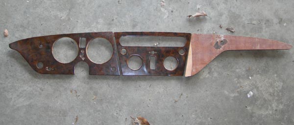

Here is a picture of the old dash that I have. I figure it is a good place to start with this reference thread. Does anyone know what year models this dash is correct for?
My guess would be 1973 or 1974 Spitfire. It can't be later, since it still has a rectangular hole above the speedo and tach for the older style hazard flasher switch. And it can't be any earlier yet "original" since the wood dashes did not appear until 1973 models.
rotoflex
Is it a custom dash that's been modified? That looks more like burled walnut veneer, which was found in Jaguars but not Spitfires or GT6's, as far as I know.
At any rate it's got cutouts for a 70s dash: Fasten seatbelts light & square hazard switch. It's missing the cutout for the demister which would be present on the GT6.

Dash cutouts match my 1970 mk3 spit (late '70 with RAF badge on front). However the late '70 dash is vinyl, NO Wood. I've thought about fitting wood dash but interior is in good shape and stock...a bit reluctant to mess with that although it would look very nice.

I believe it may be a custom dash, as you are correct in stating that it is not a fatory wood. I picked it up with a truckload (literally) of old mostly MGB parts I bought several years ago, so I have no way of knowing exactly what car it came from. Thanks for all the info so far.....very helpful.

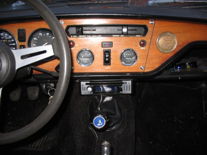

Here's a picture of my '73.
I believe the screws holding in your center section were originally black anodized oval-head philips screws on black anodized cup washers (not finishing washers).
TheAssociate
That's a good eye Rotoflex. I decided to replace those original screws with stainless screws and washers. I got tired of looking at the rusty ones that were in the dash. They are not recessed like the original, but in my opinion are better. Is it possible to improve perfection? Well, yes.
Adam.
