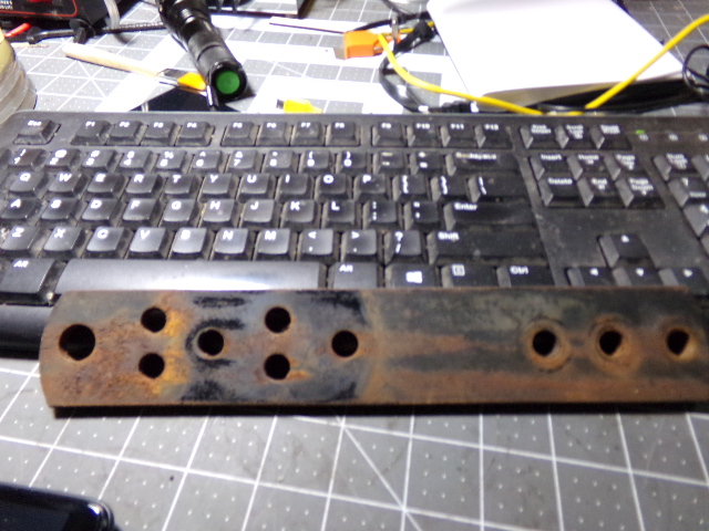

Can someone tell me what this is for, there are 3 of these and I think it has something to do with the front bumper?
Bayless
Nothing like mine. I don't think there is anything like that on my car and I have probably touched every piece on the car at some time. Also,we need some new photos of your Prefect.
JPSmit
I think the top one is to make your computer work. The bottom one, no idea. (I'll get my coat)
