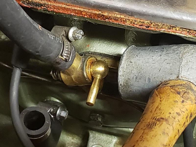

It may leak. Mine did - but not through the gasket. Moss explains this type of valve, with modern mfg techniques and without hand lapping, has a tendency to leak.

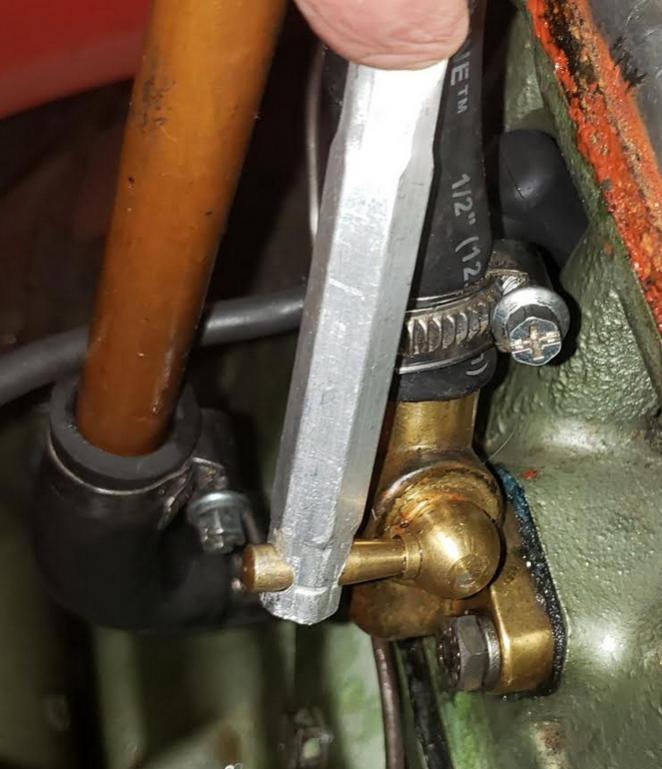

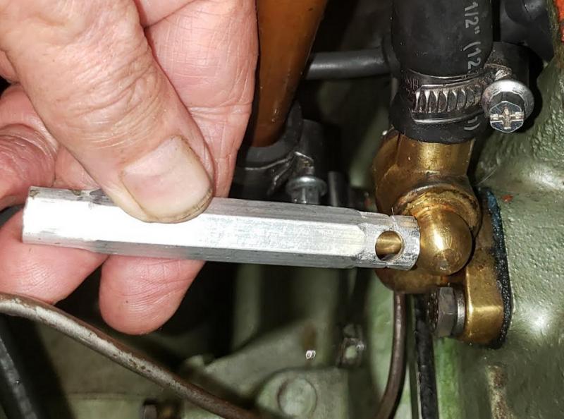

I tap it with the lead hammer to seat it - no leaks. Made tool below to free it up for easy hand-turning without stressing the brass handle. From a piece of EMT and a cut-off bolt:
