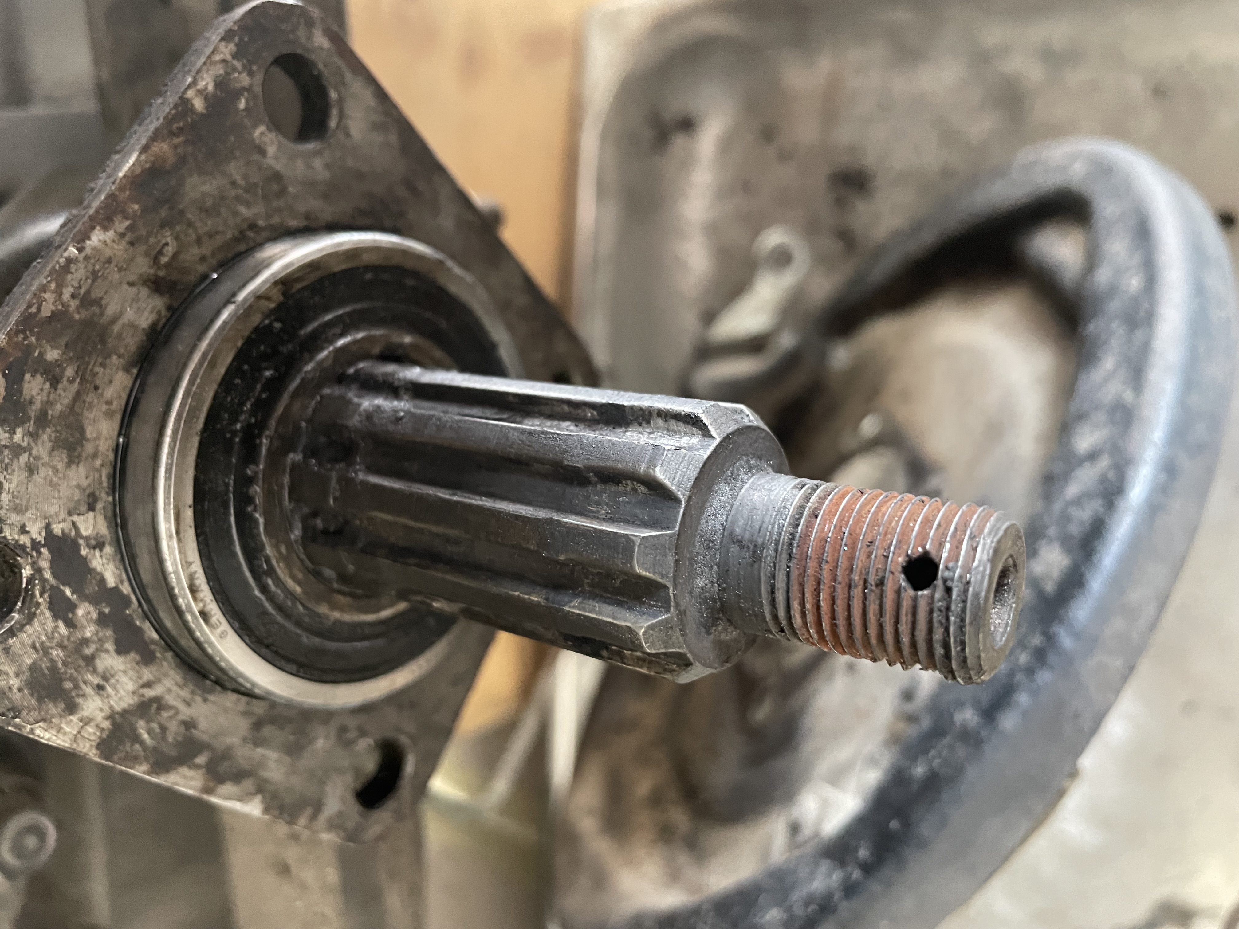

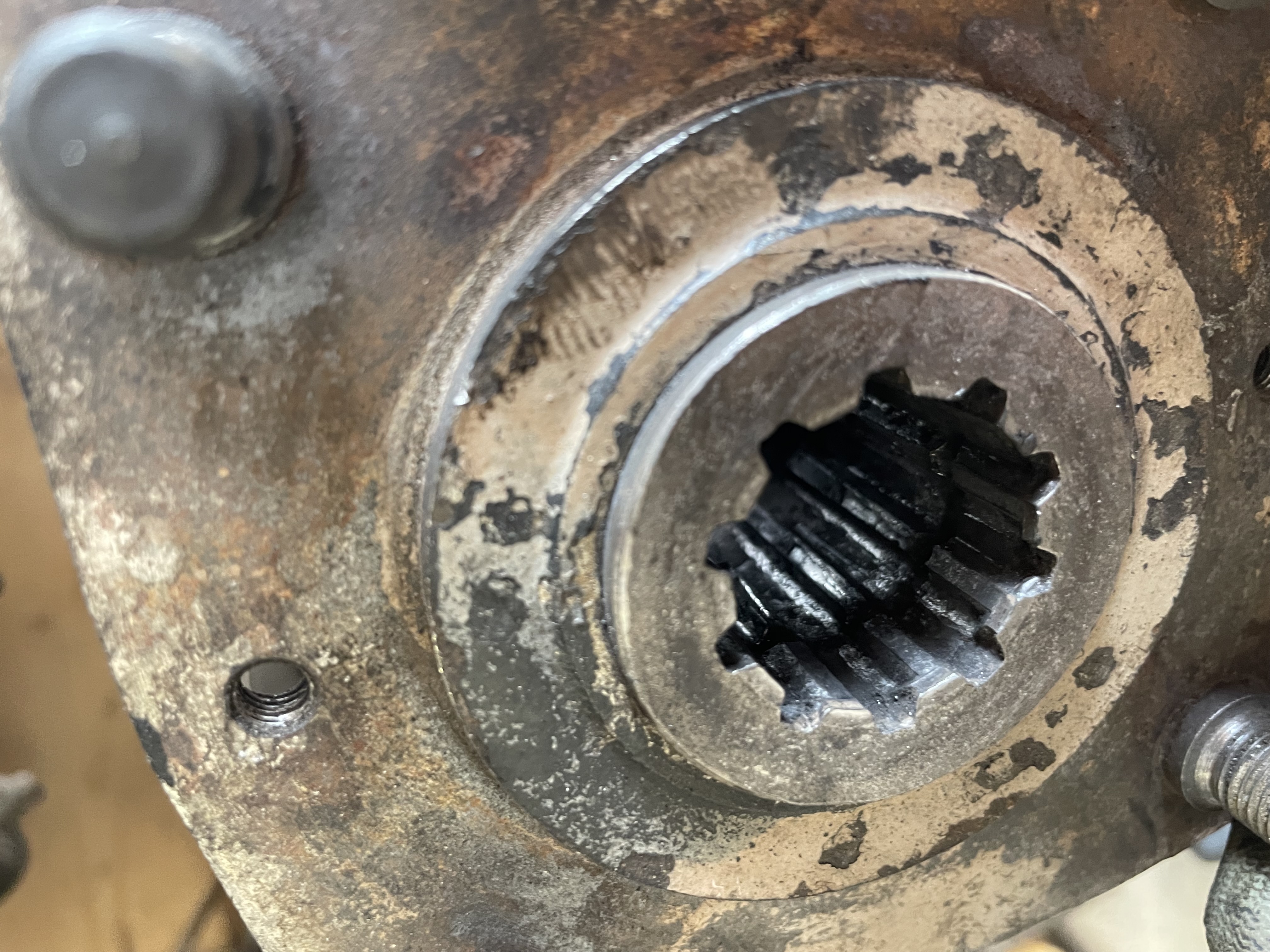

Nanhook
Actually you was right, I am in front of bearing quite easily but, now I am not sure the problem is the bearing , can be is the hub my problem?I mean, hub is not very thigh to the shaft axle and I find few metal dust…
Nanhook
If I only could post a smal video I could show hub move on shaft axle
CJD
If you look closely inside the hub, you will see a split about an inch inside the splines. That is where the locking collar is still in the hub. You should be able to catch it from the back side with a punch ( or gently on the outside) and tap it out.
The locking collar is tapered on the outside, to center the hub. As you tighten the hub nut the collar centers the hub, and as you continue to tighten the nut, the collar compresses onto the axle splines, locking the hub to the axle. It is possible the nut was not tightened properly.
