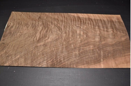

Now for the veneer itself. The original on the Plus 2 was a fairly striking burl, traditionally English Walnut or European Walnut, not easy to come by particularly in the size needed for a dashboard. I’m not sure Colin was very concerned about the species either so I suspect what came on the cars was quite variable.
The options for replacement veneer types are quite numerous. There are plain or raw wood veneers, paper backed veneers, foil backed veneers, peel and stick veneers, “flexible” veneers and even plastic veneers.
I chose the raw wood veneer since I am as much interested in the process as the result even though I knew this would be the most difficult. What I wound up with after quite a bit of searching was two book-matched pieces of “American Walnut”. It’s quite figured but somewhat of a stretch to call it “burl” but it was available and reasonable. I got 2 bookmarked pieces for about $30. Much prefer to risk $30 than $200 on this experiment. Here is the raw veneer (two identical pieces.) In hindsight, a backed veneer would have eliminated most of the problems I encountered.

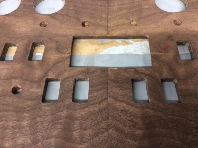

I did not glue the book match joint before hand which had been suggested. I did not see how a butt joint at 1/40th of an inch could be reliable and thought that the tape I had on it would hold as well but it did not. The lack of dimensional stability also warped that seam line and made it visible. Also note the edges of a defect in the veneer (faint red arrow) that I oriented so most of it would be in the ash tray cutout. Those pretty much went away with the lacquer, the wide seam is still noticeable.
My plan was to leave the glove bx door out at this point and carefully cut out the laminate that laid over the opening and then lay it on the cover separately. This actually worked but I was not careful enough in clamping around the aperture and the knife tore the veneer a bit along on edge. This was my inattention to that detail rather than a fault in the process.

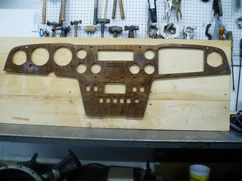

Here it is after 6 or seven coats of lacquer. I think it will do.
Tom

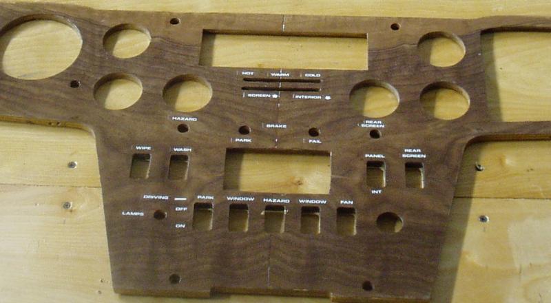

Here is the new veneer with lettering:
The letters were from RD Enterprises in PA. The are not transfers but printed on a very transparent material. The material stays on and shows but barely. I covered them with a couple of coats of lacquer. Not for Pebble Beach but OK for Thursday night cruise in.
I did request a quote from a printer to have transfers custom made but have not gotten it yet, but surely a lot more than the $14 from JD.
Tom

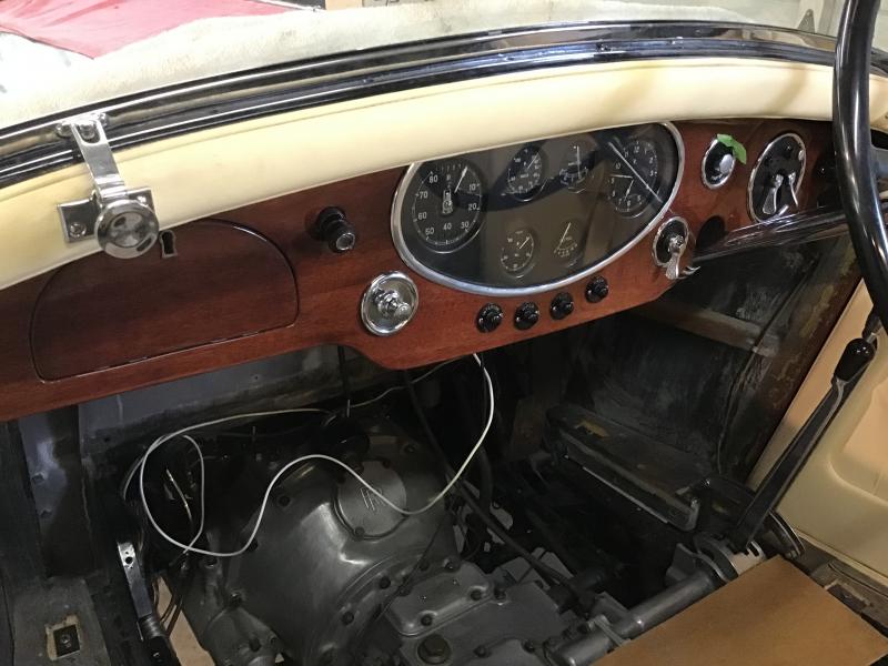

Grantura_MKI
Cheers, Tom. Picture doesn’t show it, but it has a painted edge as per original. Put about 7 coats of clear on it.
The bit I am not fond of is cutting out the holes.
