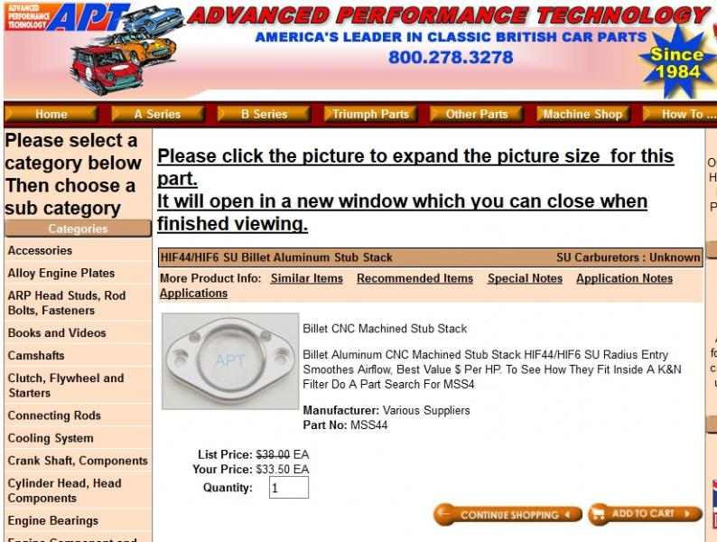

Can you access the inside of the CAB?
The reason I ask is if you could, you could perhaps install the APT stub stacks inside the box.

Steve--
Yes, I could easily do that but what I am considering is to get rid of the CAB because it is such a pain to work around.

I got a pair of stubby stacks from David Anton at ATP when we were prototyping a K&N setup for BJ8/HD8 carbs. Can't say if they added any power, but they are well made. Can't see how you could possibly fit them inside a CAB.

I use two bolts to fix the CAB to the carbs which thread through rivnuts in the inner face of the box and pass through the front mounting hole in the front carb and rear mounting hole in the rear carb (both of which have the threads drilled out of them to accept the diameter of the bolts) and are nutted from behind the carb ears. By removing these two bolts and using slightly longer ones to accommodate the thickness of the velocity stack I could install the short stacks inside the box.
I may order a pair of short horns and install them in the CAB as above. Or I may go for a more radical look, get some long horns and scrap the box. Or, as so often happens with these projects, I may simply continue to think about it and do nothing until the next time I must deal with getting my hands under/around the box and then rethink everything again--we'll see.
