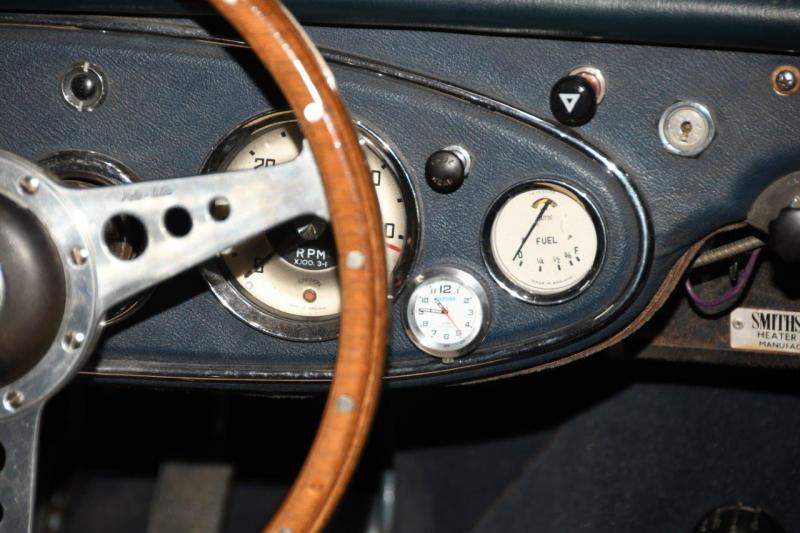

We're running the Toyota 5 speed in our MK II BJ7, so the o/d switch is redundant, and I like having a clock on the dash. We removed the o/d switch and zip-tied it up behind the dash and mounted a battery driven analog Oxford clock normally sold for motorcycles etc. (see https://www.oxfordproducts.com/moto...ling/oxford_clock_silver_case_and_white_face/
It's a white face, silver trim, they also have a black face/black trim and a white face/titanium trim version. Two mounting options are provided, but we basically used a stack of washers. There's no need to modify the dash (unless you want to shift the clock over a bit to make it more centred). We've had one in our dune buggy for over a year (same battery) and have been very satisfied with it.

Dang! I thought I'd done everything correctly to post a photo of the dash mit clock, but no success. I used the attachment facility; browsed; selected my file; hit upload; etc. I didn't see the photo as part of the preview prior to posting but it appeared in the managing the uploads/attachments so assumed it would appear in the finished, loaded, version. Guidance would sure be appreciated. DOug
NutmegCT
Doug - if you hit attach, you won't see the photo appear in the post. It'll just be a clickable link under the post.
If you want the photo in the post itself, click the "picture" icon (third from right) above the text window.

Here's what it looks like, installed. Later, Doug
