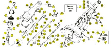

I've reached the 6000 mile maintenance mark on my 59 TR3 and have been doing all the required lubrications. When I got to the clutch shaft bearing, however, I did not find the grease nipples (zerks) pictured in PH or in all the other drawings. Where the two zerks should be I found only a solid caps, with no indication that there had ever been grease fittings there. Can anyone explain this to me?

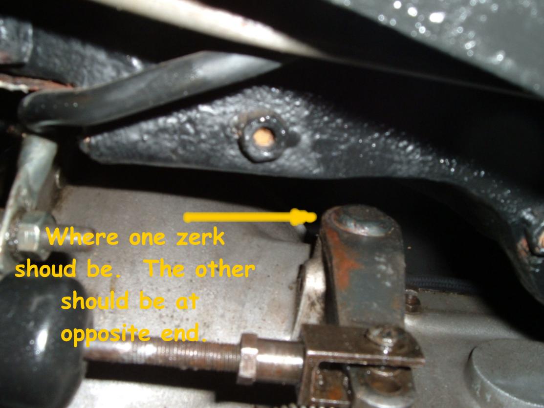

UPDATE: Here is a photo taken quickly...

Sorry, Ed, my mistake on the 4-synchro. But I still agree with Keith, that is the later shaft which does not come with grease zerks.
The reason my Stag looks different is because the clutch slave is on the other side, the shaft gets installed backwards. But the parts manual shows the lever on the left, which has caused several mechanics a lot of grief. Removing the gearbox is an adventure in pain on the Stag (I literally wind up bleeding every time) and there is no other way to turn the shaft around.
