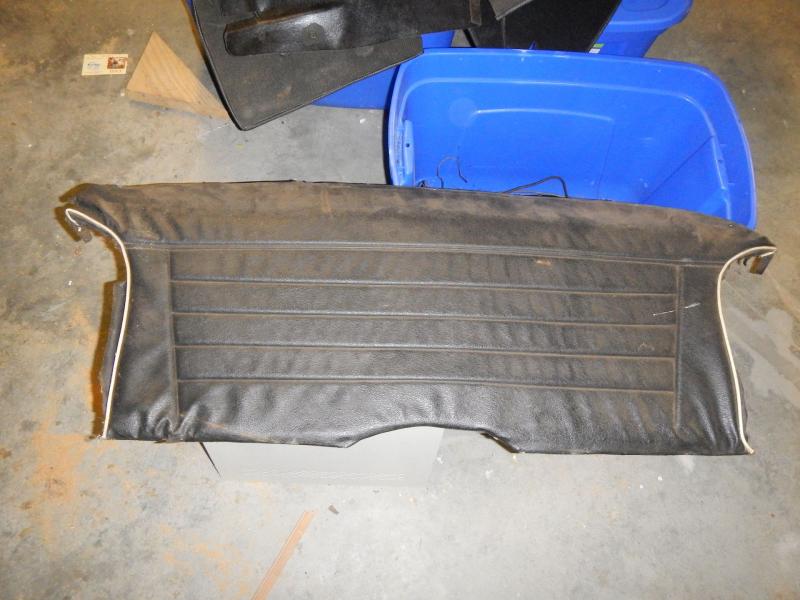

Kleykamp
seat.jpgThe back section is a upholstered hard board that covers the gas tank, as Randall said. That item was used on all cars. The seat bottom is a plywood with foam and upholstery. The bottom "seat" was an option. I don't have the catalog handy but I'm sure Moss, Victoria British and Roadster Factory have them. You would have to buy the hard board, which is shaped to fit and I think the upholstery part is sold separately. Another source is 2tall custom interiors which post a lot on ebay for interior sets and seat, but would provide individual pieces. I occasionally see the back sections on ebay too.

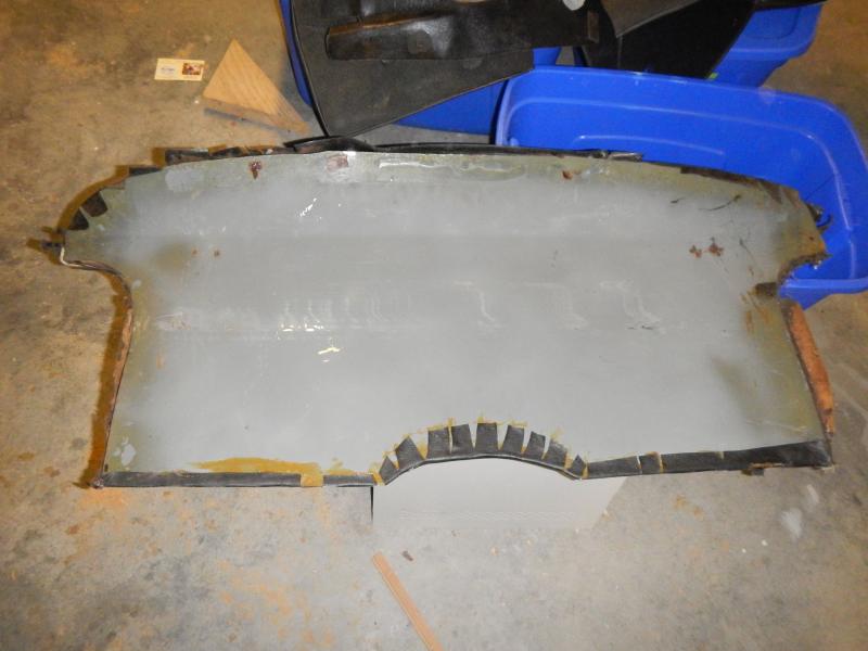

Geo Hahn
Here's a look at the backside of mine - it's a TS47000 but possibly what you need is similar.
Not much to it - main panel is Masonite, top bit (curved) is sheet metal. The 1x2 is a reinforcement I added. With that basic framework the upholstery kit would complete the piece.
TR-3rg
Hi Paul,
I posted a couple of photos and a Masonite link for forming the shape on 7/22 "Rear Seat Mill Board". I made a fixture to bend the Masonite. Its pretty easy to do it. I recommend trimming after its formed, or it will probably crack. I used my old millboard as a pattern.
RG
