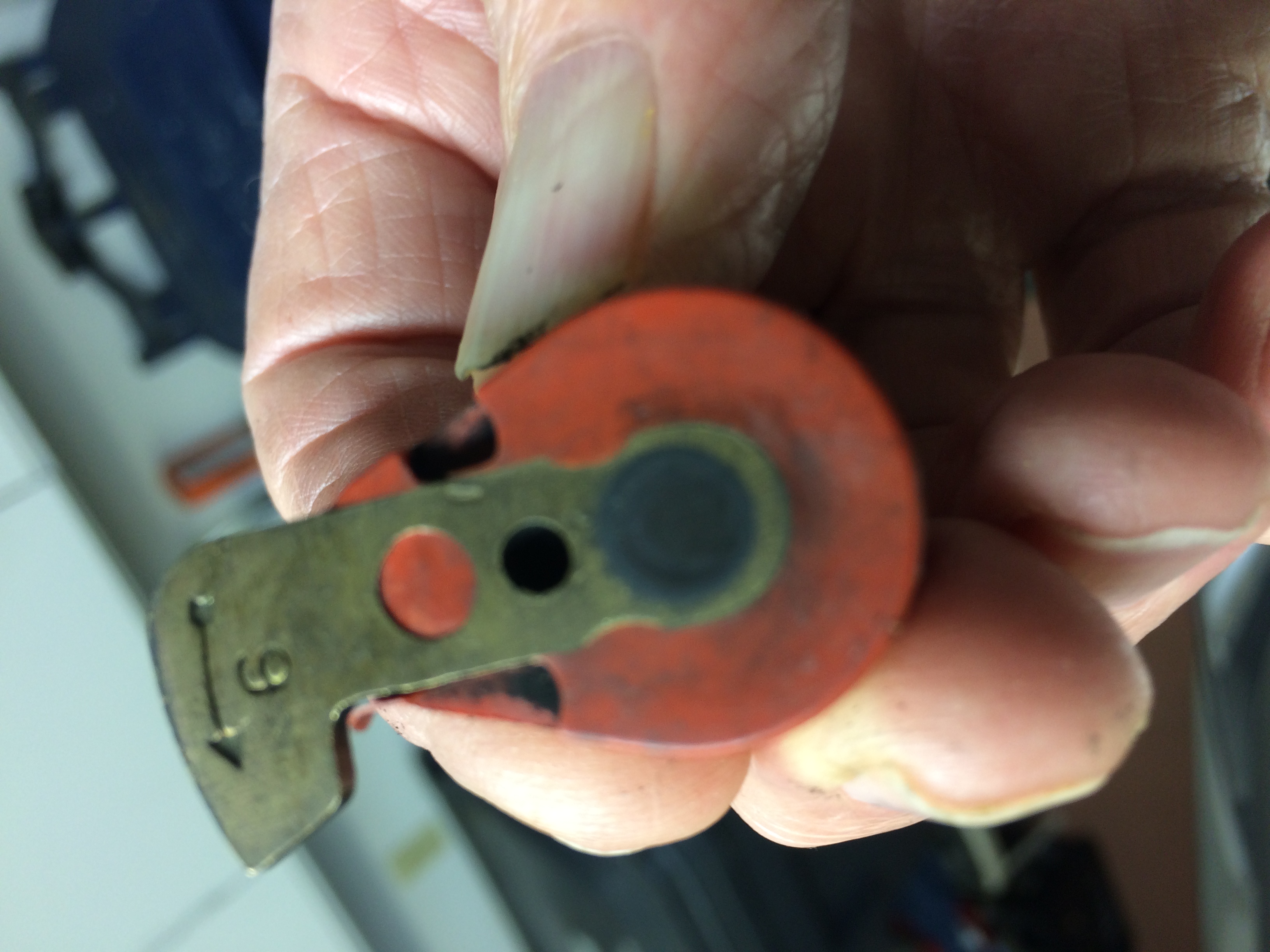

My car seemed down on power today so I started to check the points. Opened the distributor cap, everything was coated with graphite, turned over the cap and guess what's missing???? Not a bit or piece remained. I'm amazed it ran at all. My question is "is the graphite electrode available by itself?" Does anyone know of a substitute for a quick fix?

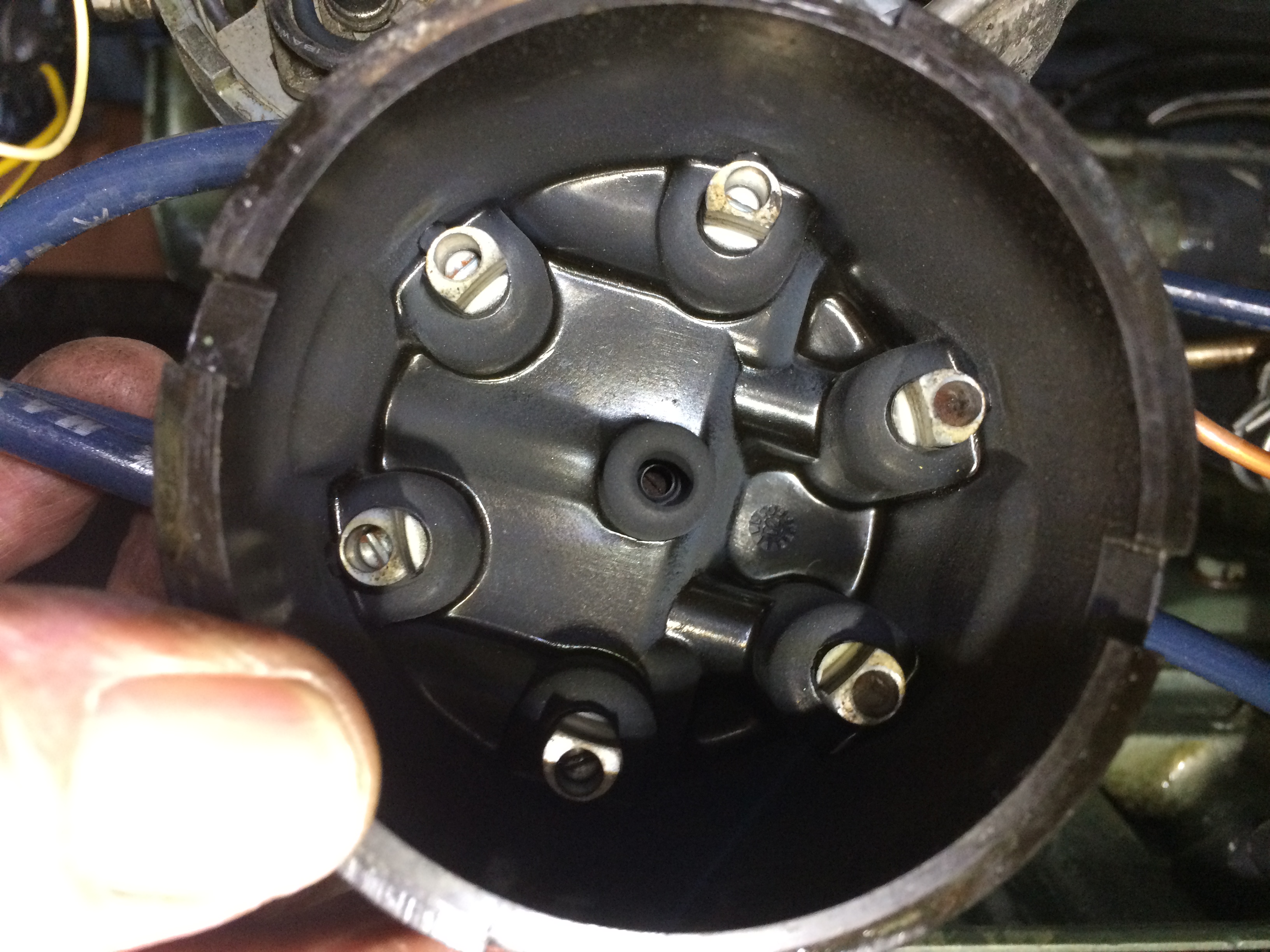

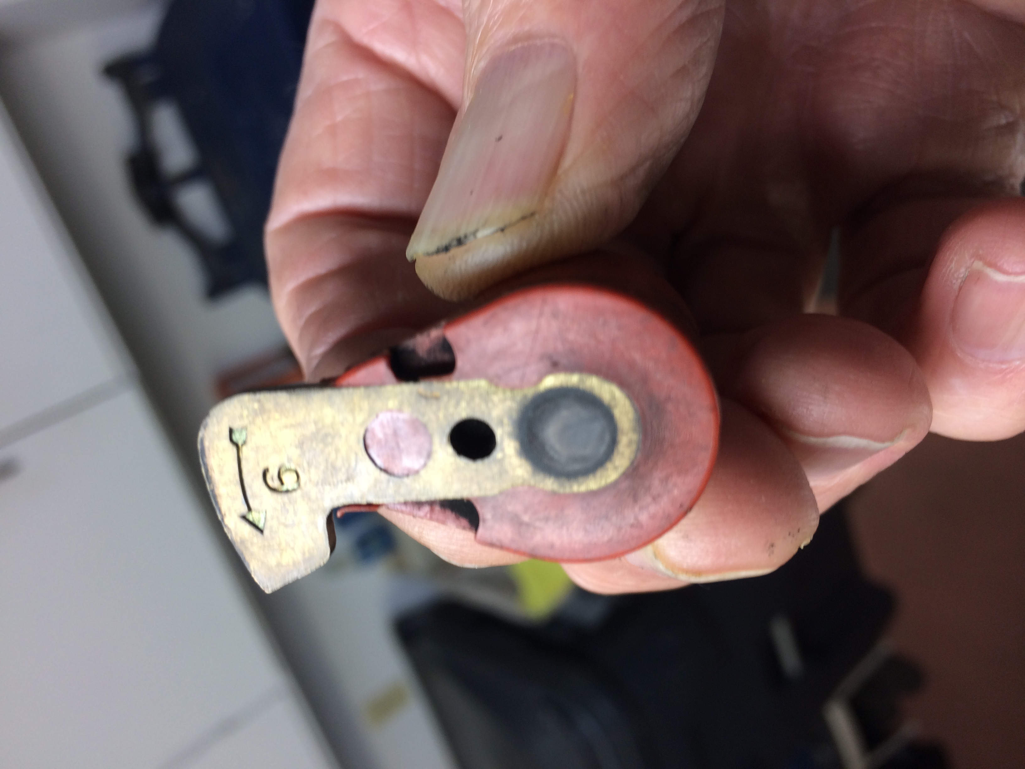

Craig, Here you go. I found a used cap in my spares and switched the HT leads and am back in business. I did notice the electrode hole in the old cap was slightly larger than the one I replaced it with. Don't know if it was that way from the beginning. The failed cap had been on since 2006.

On the failed cap, the spring was still in the bow but there was not one bit of the carbon electrode left. I had a new electrode and spring which I installed in the replacement cap. Thank you to the person who, on an earlier post about inserting the electrodes, suggested “winding them in at a 45 degrees angle”. It worked perfectly.

I would replace the rotor also if you look carefully at it there seems to be arcing on either side of the brass contact.---???

RD, I noticed a small shoulder in the bottom of the electrode bore that surrounds the spring when inserted. If you try hard enough to push the graphite electrode too far into the bore, I can see where you could jam the soft electrode past that shoulder area and it would come stuck. Its a bit tricky to push it far enough to seat the spring, without jamming the graphite portion.
