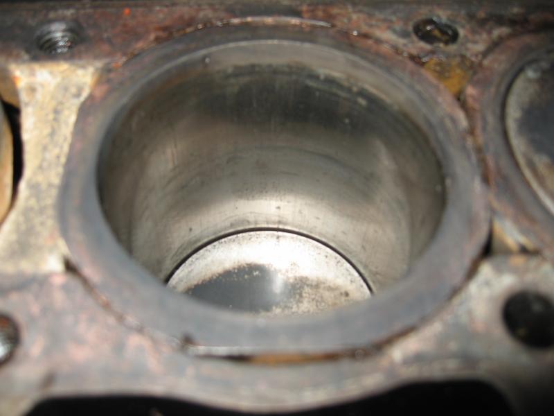

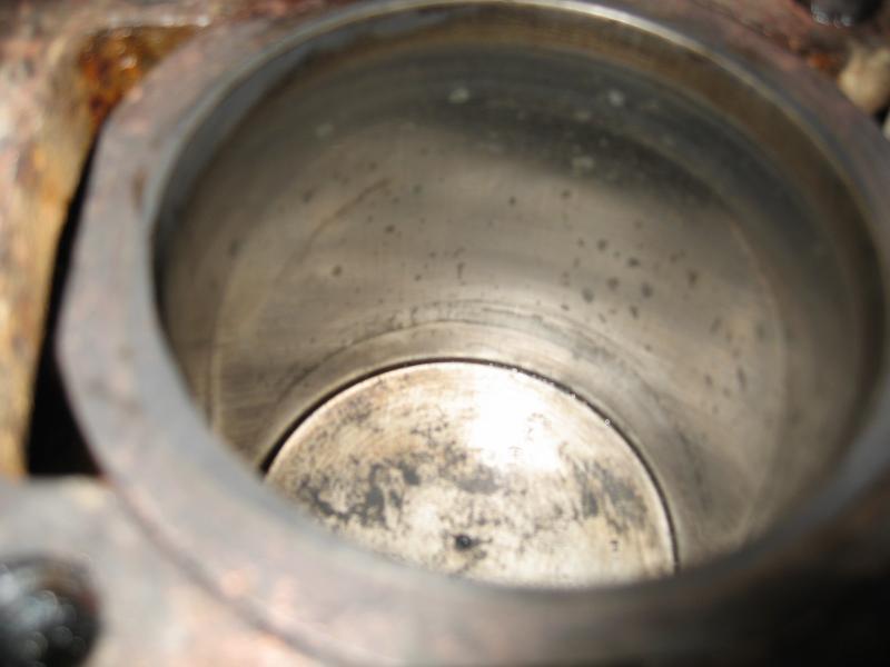

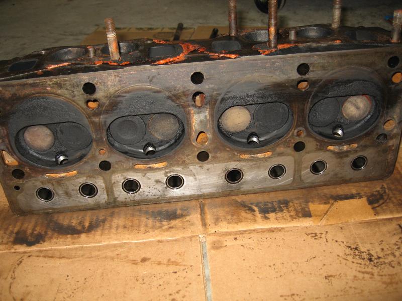

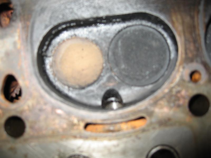

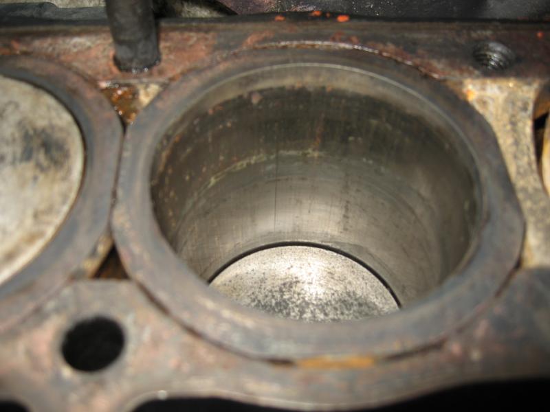

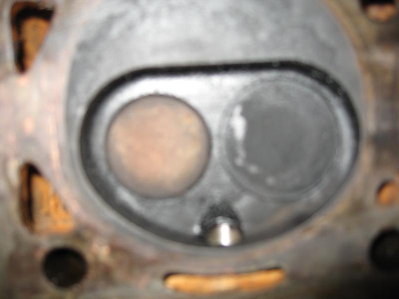

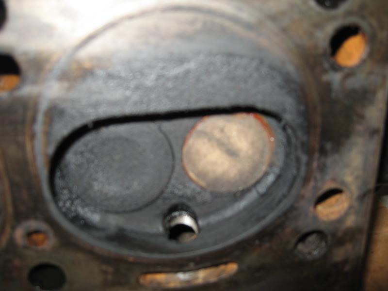

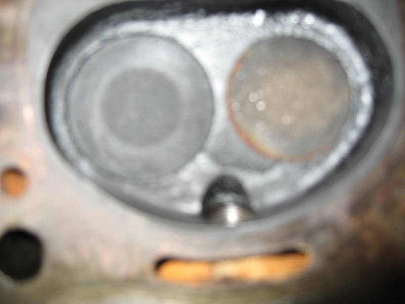

Finally got the head off. I managed to get all the studs out except two and then manhandled it off. The idea to use small wooden wedges (shims for door and window install) was a good idea as I could move it slightly and this got it started equally on all sides. Once it was loose, it came right off the two studs. TOC, the water was coming out by the head gasket. The block still had water in it despite opening the radiator and block drains. The block drain was completely clogged.
Pictures below, the number 2 piston and head area didn't look the worst, but there is a definite ridge in the cylinder at about where the oil ring lives at TDC. The severity of the problem, 87% leakdown, and the condition of the water jacket have me thinking a more extensive overhaul.
