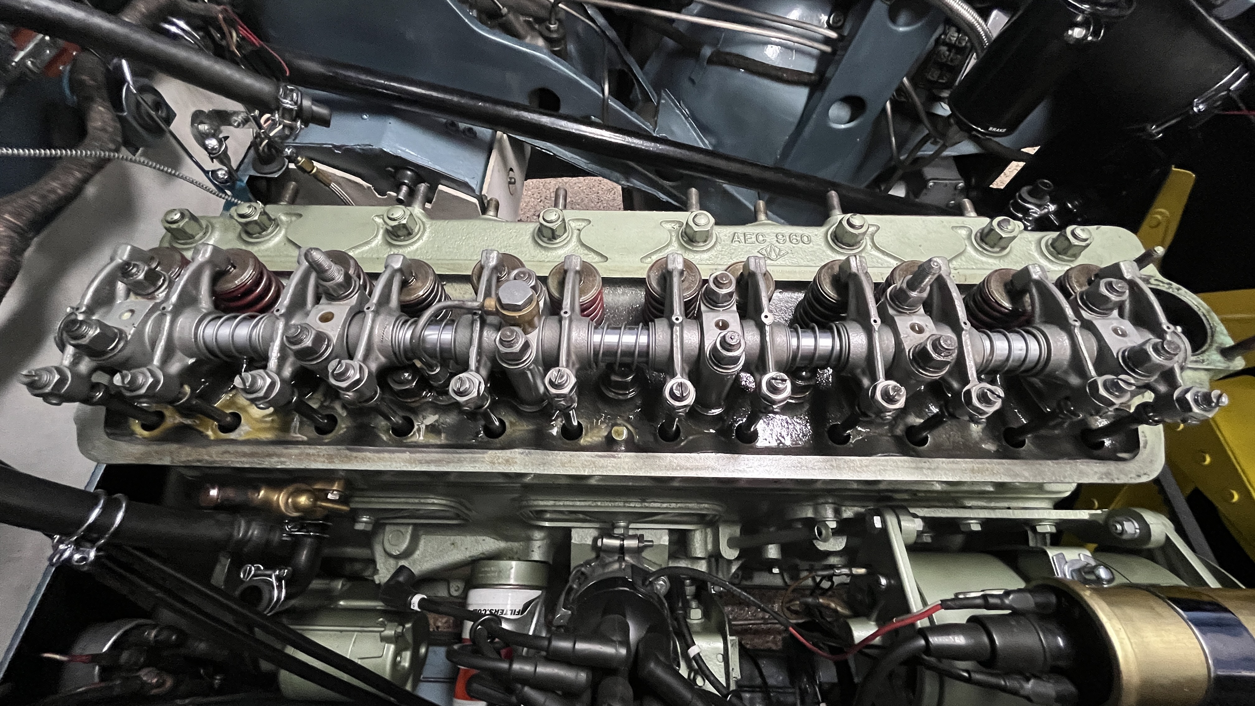

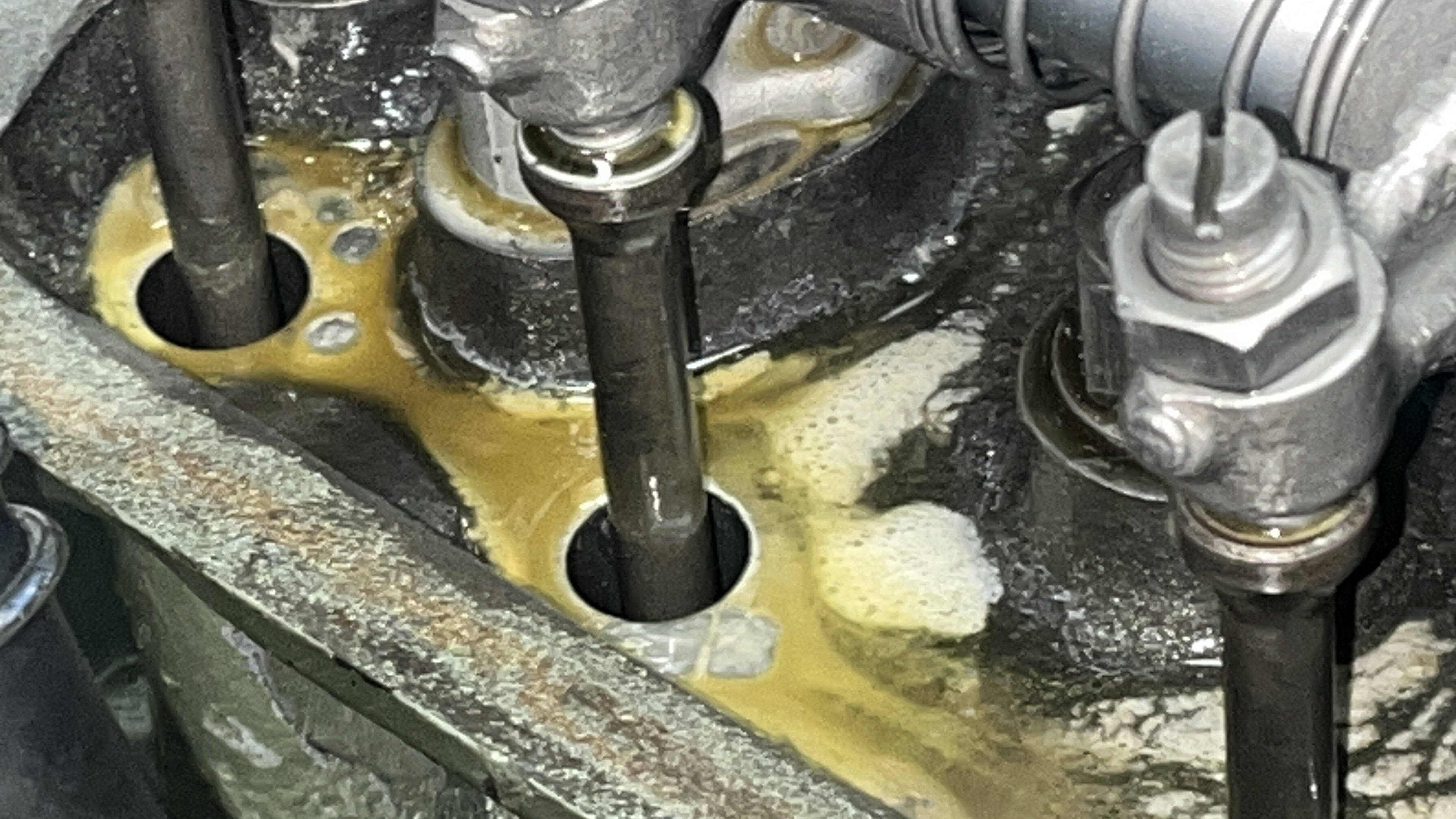

My head gasket leaked, with just 500 miles on the rebuilt engine. Showed between block and cylinder head and top of cylinder. I'm replacing the head gasket.

Any oil that comes in contact with water / coolant will look like mayonaise (emulsion, see your picture)
That should be visible (in the oil) at the first drain. Repeat as much as you like until you feel good.

Thanks BigGreen,
"Just give the oil time (over night) to leak."
Jacked up the front so the oil will collect at the drain plug. Drained overnight to get as much oil out as possible without removing the oil pan.
Happy to say the oil I drained was black and not mayonnaise looking. Only noticed that on the cylinder head, which is interesting.

Emulsion on the top could be from condensation (short drive, reduced cranckcase ventilation)
For oil to turn white from coolant it does not need the engine running. To be sure check under valvecover.
I would be happy after draining oil that has no white and stop there.
