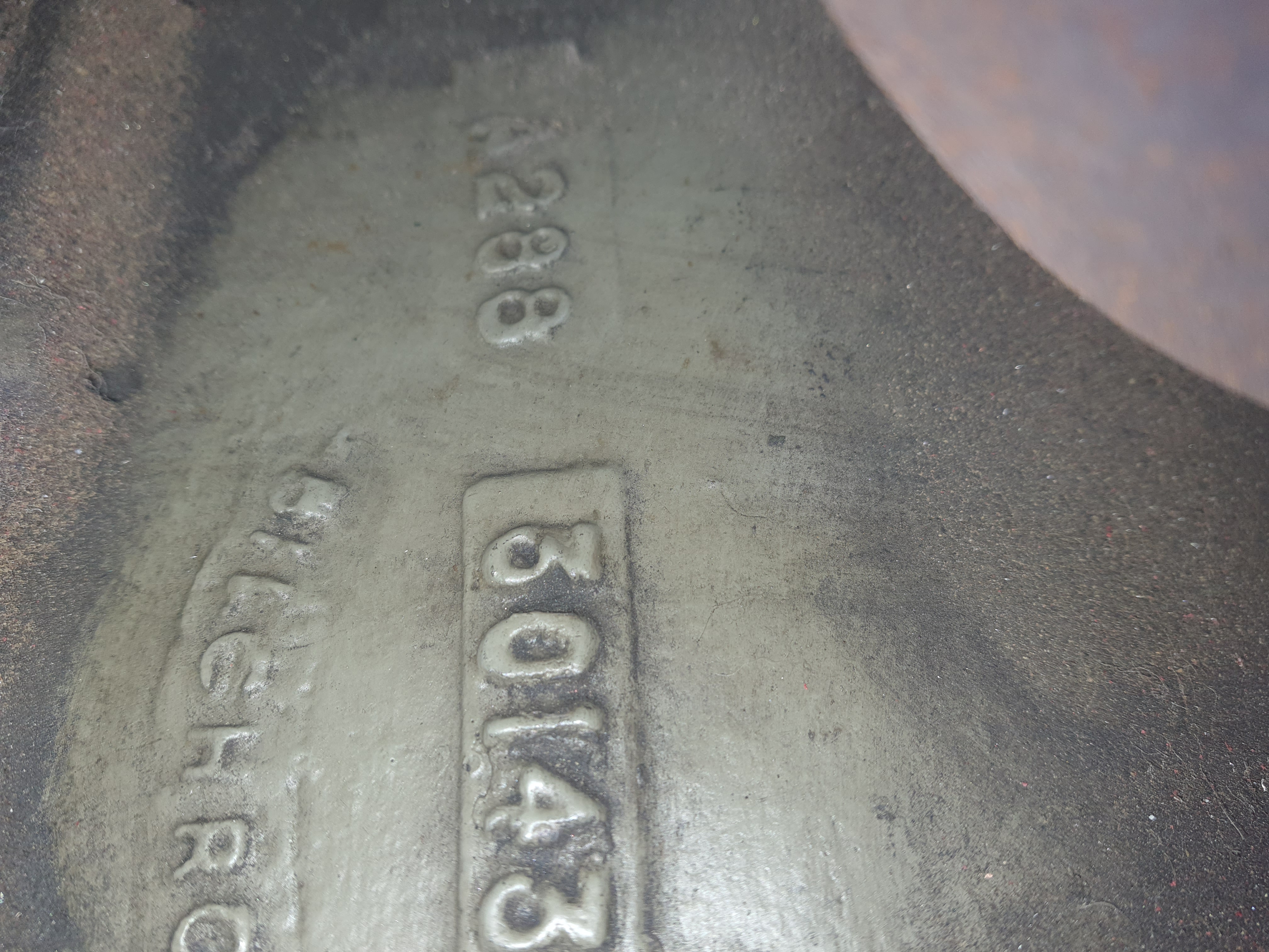

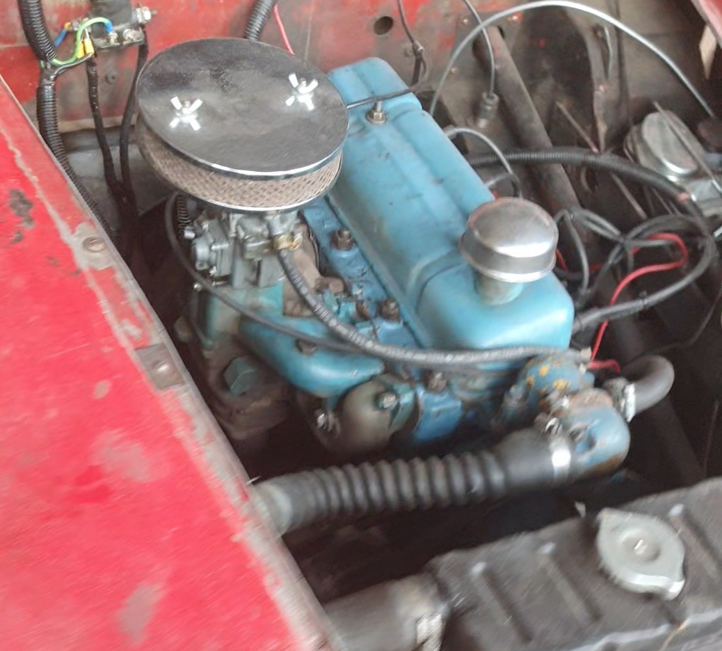

Hello all,
Please help identifying the engine of the attached pictures. I was told it is a Morris engine 1958, but I can't confirm it.

Jerry
See if the engine plate is still there. Usually under the exhaust manifold at the front of the engine?
Devon County
Hello all,
From the colour and rocker cover design it looks like a 1970's Datsun. These were based on BMC engines. If it was Austin Morris etc there would be something cast on the side. The B series had 1622 or 1500 and Austin or MOWOG. Can you get any photos of the side of the block?
