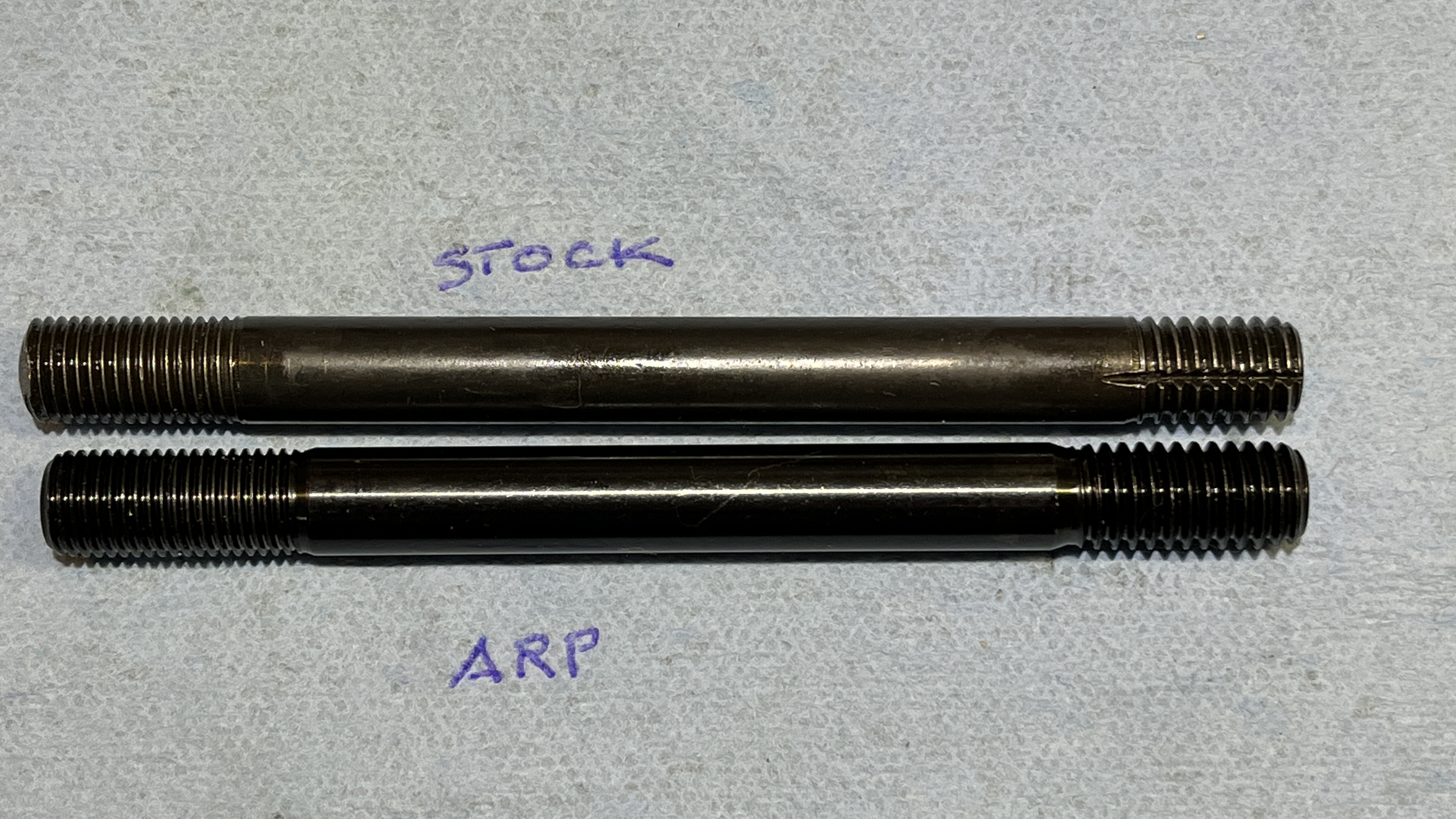

1. Stock stud next to ARP; notice the length of the threads.

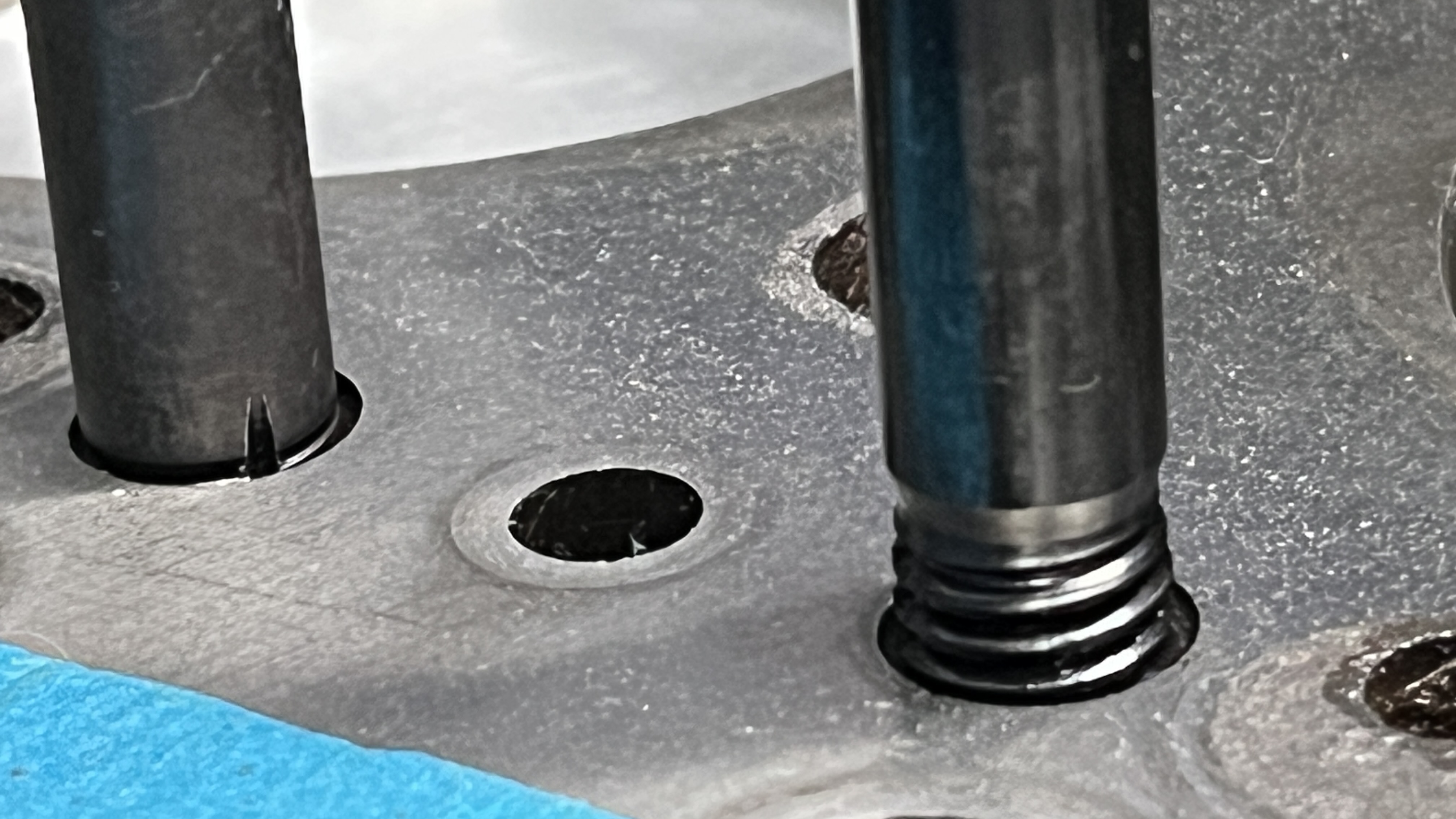

2. Both studs taped to show how far they enter the block.

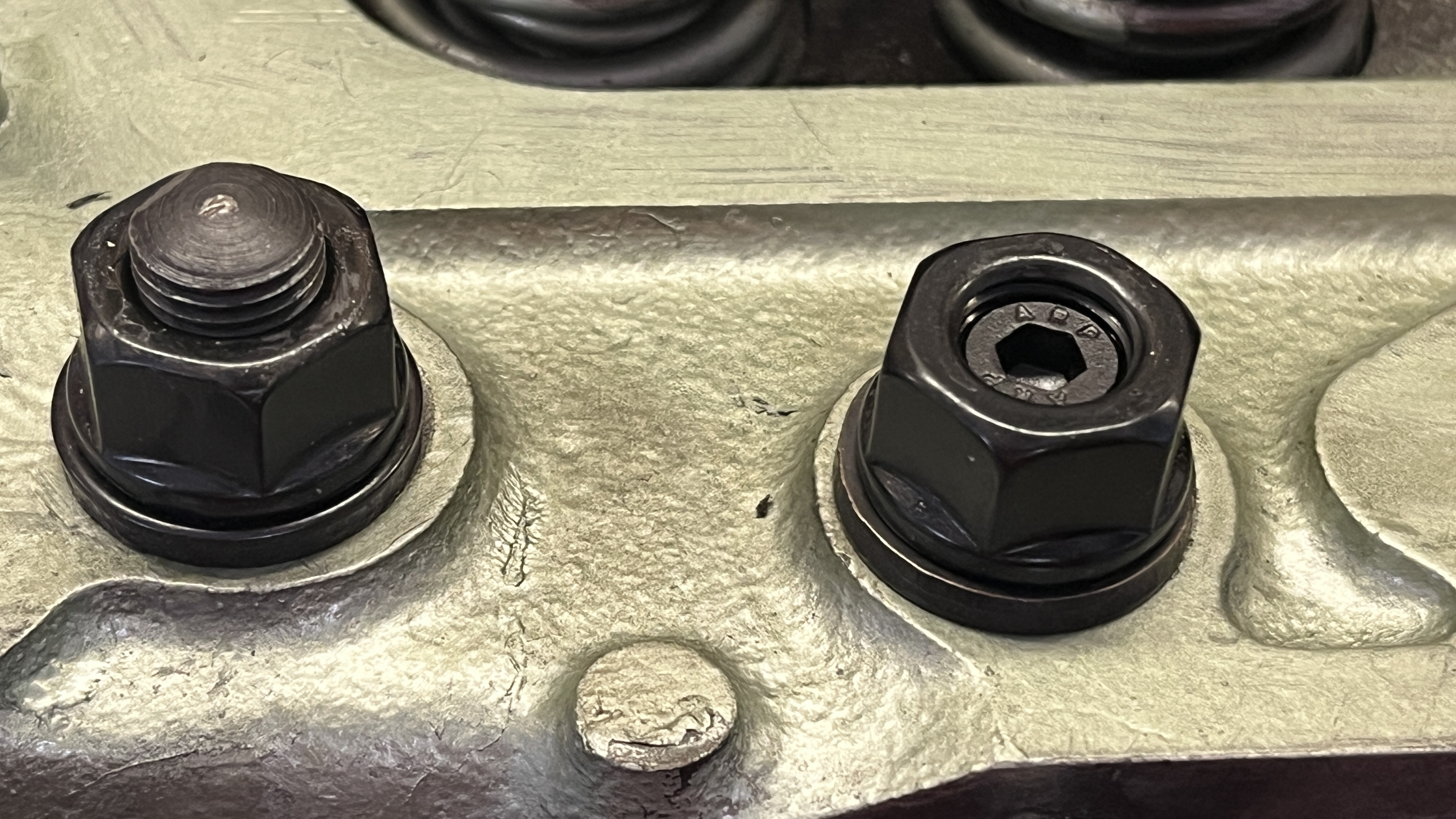

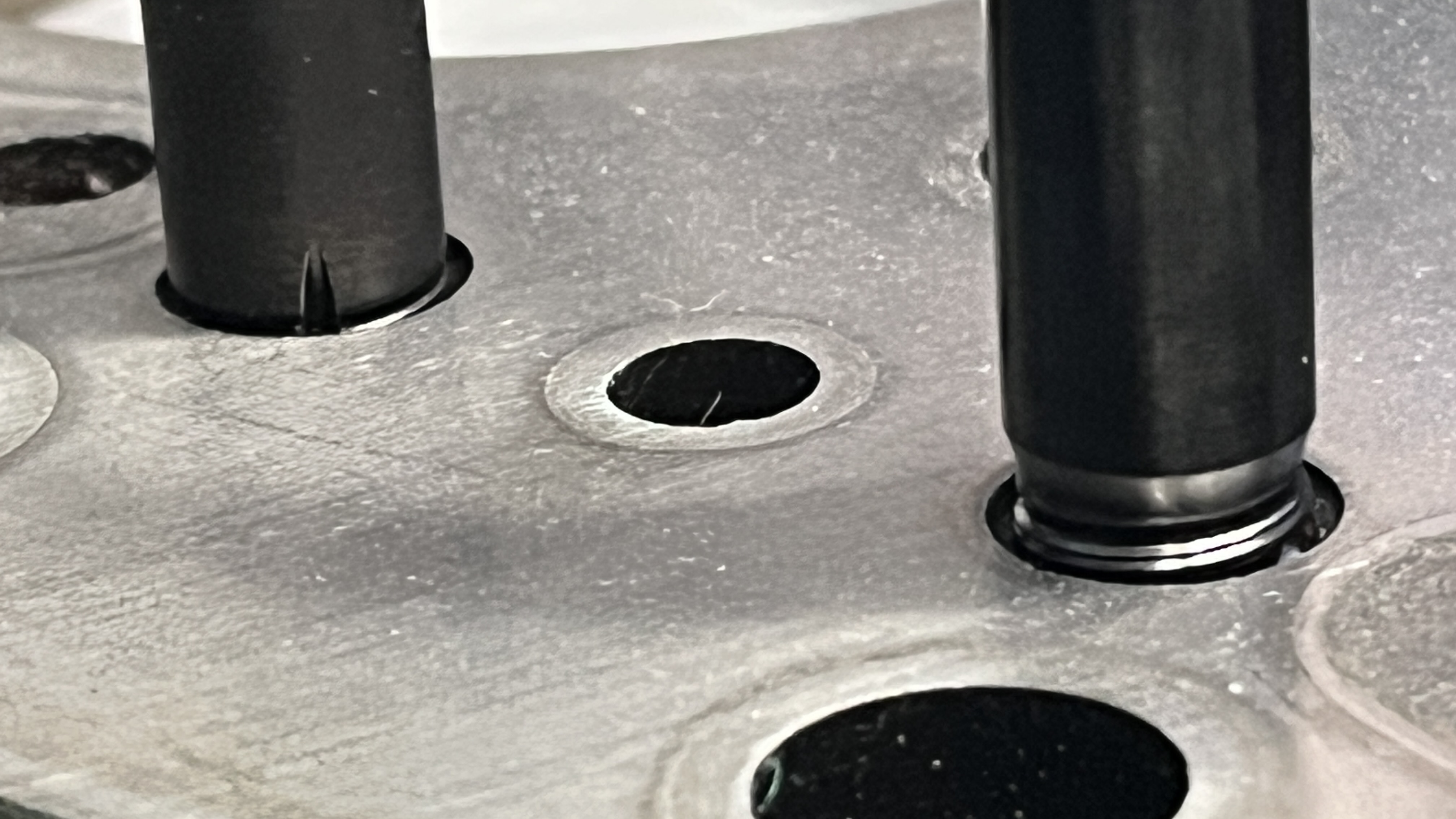

3. Stock stud inserted finger tight until shank. ARP finger tight to bottom of block thread hole.

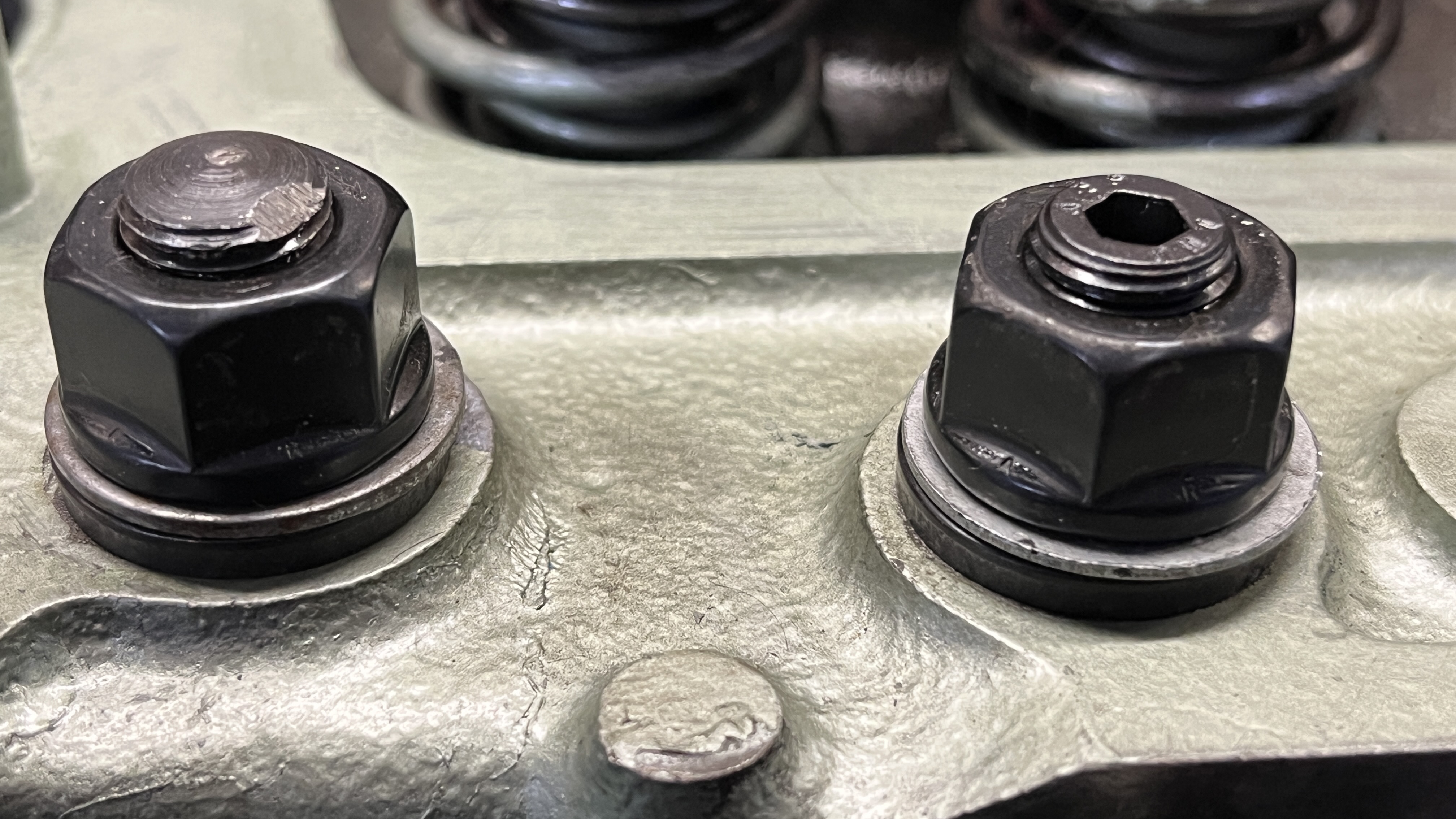

4. How far ARP stud extends into the cylinder head nut.
5. Stock stud inserted finger tight until shank. ARP finger tight 4/8" into block.
6. How far ARP stud extends into the cylinder head nut.

The general rule is to insert the studs so that the top of the stud extends about one thread beyond the nut when tightened. You will need an Allen wrench to adjust the stud height.
The extra washers (zinc-plated, pic #5) are those to account for test assembly without the head gasket in place?

I use ARP studs on all the BMW I-6 engines I've built (they were originally fitted with TTY, or one-time use bolts) and with those I am always able to hand thread them in until the non-threaded shank stops on the top thread in the block, same as what I'd expect to do with your Healey.

Yes, zinc washer to compensate for HG.
