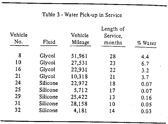

What kind of brake fluid are you using? The only time I've seen that much sludge was when the brake fluid was not compatible with the seals, and was slowly attacking them. Used to be that American brake fluid was not compatible with British brake seals, but I've not heard of that happening for many years.
Also note that DOT 3/4 fluid should be changed every few years, whether the car is driven or not. The fluid keeps OK while in a sealed can, but basically starts to deteriorate as soon as the can is opened. Which is why you are also supposed to start with a freshly opened can, and discard the leftovers afterwards.
I was told, long ago, that if you want to flush, use only methanol (aka methyl alcohol, aka wood alcohol) and dry the lines thoroughly afterwards. I did that when I converted the 3A to DOT 5, and it seemed to work out OK. But the only place I could find methanol was the local drug store, and then only after asking the pharmacist for it and explaining why I wanted it. It being both poisonous and easily mistakable for either drinking or rubbing alcohol; they don't like to sell to just anyone.
