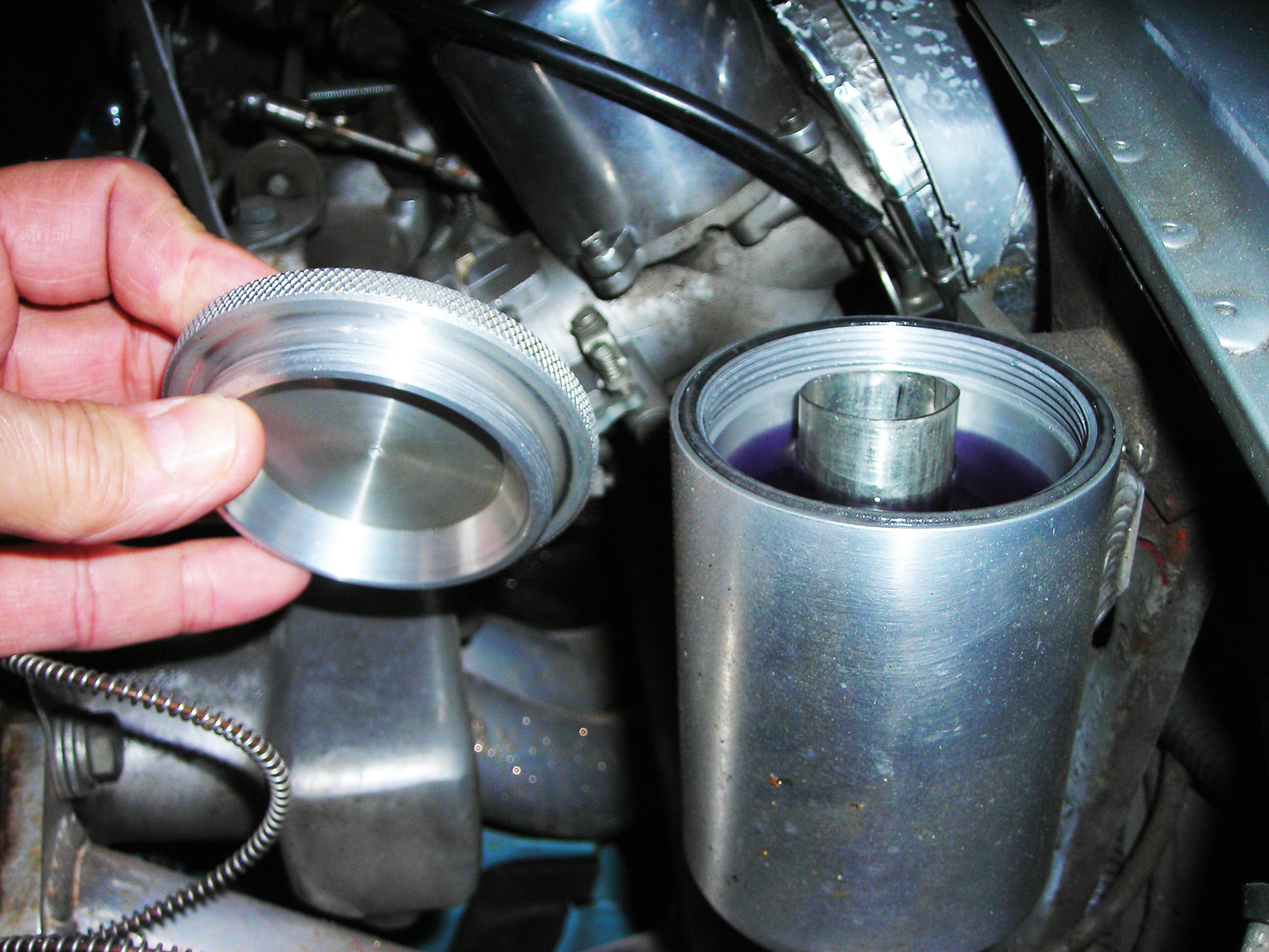

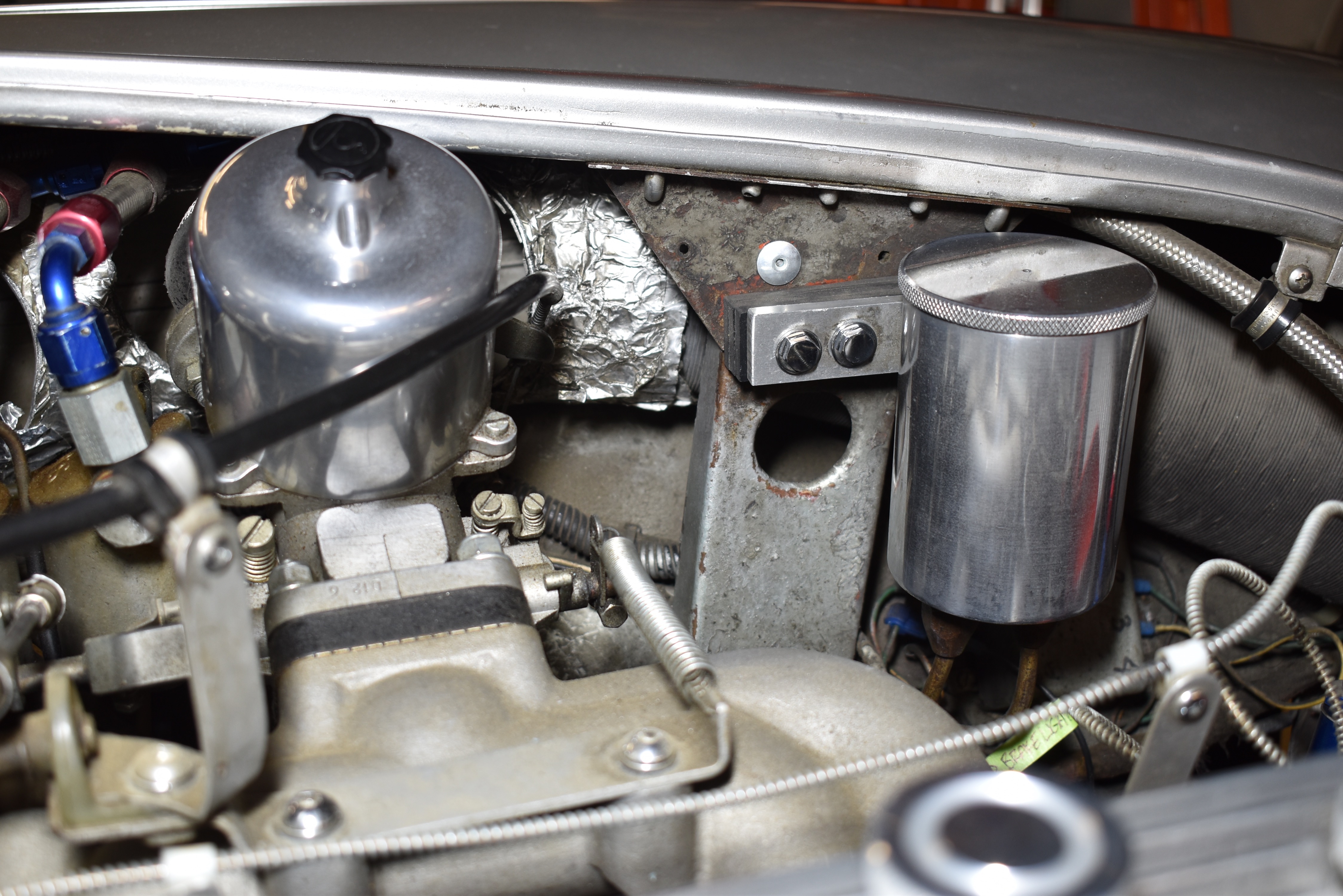

I was never happy with the messy Brake Fluid Reservoir and after some thought I came up with this idea for
an Aluminum Container.
Knowing a guy at a local machine shop helped and after running this idea past him he came back with this container.
He deserves the credit for "knurling the edge of the cap" for easier removal and for "in-setting an O-Ring" in the top edge of the container.
It never leaks anymore and retains it's natural brilliance with some Mother's Aluminum Polish.

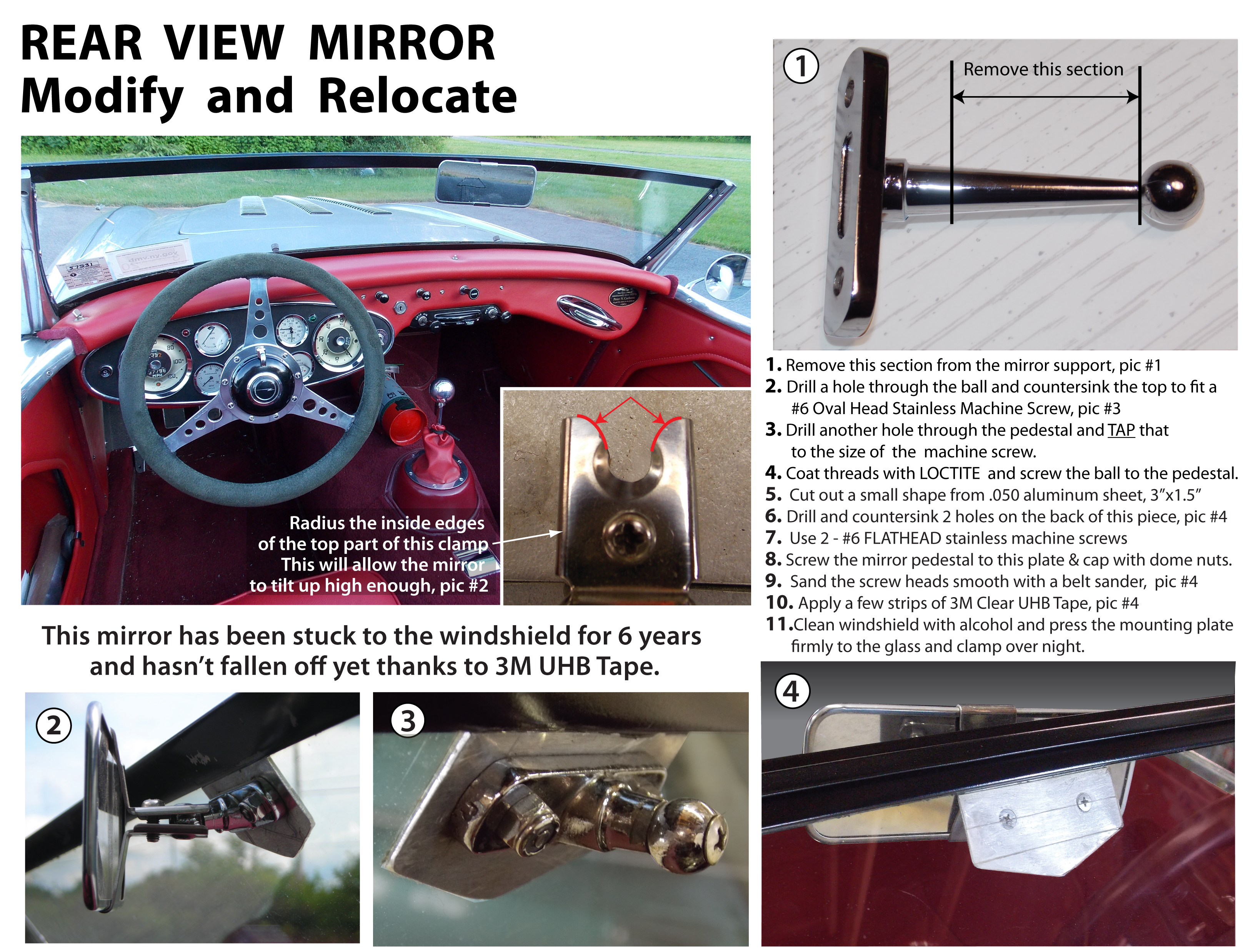

This Rear View Mirror modification is another improvement I've made.

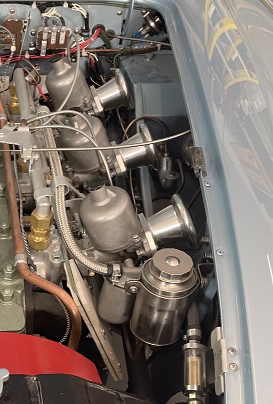

Healey Nut
When in doubt, go stainless. Mine was made by the original owner of my 64BJ8 and I kept if for my little rally recreation. It’s just stunning with the indexed cap, etc.
