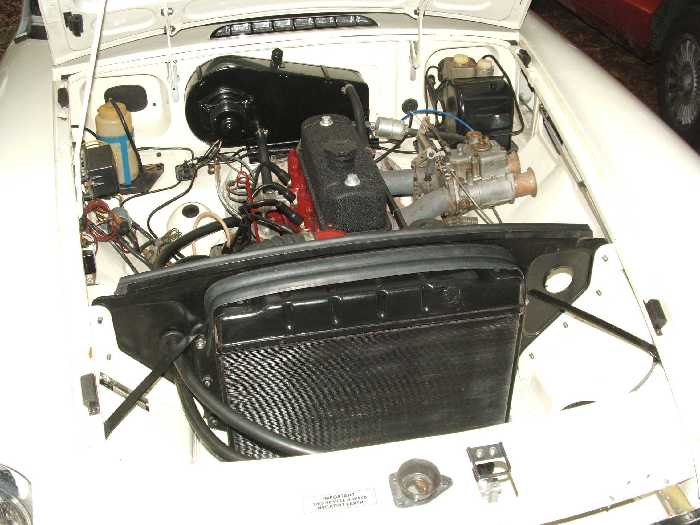

Here's my '64 for comparison(obviously with alternator and radiator overflow tube and tank).

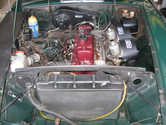

And another:

With the breather pipe. Makes more sense as an early mill, too. The one I posted is an 18GB (5-main) in an earlier chassis.
