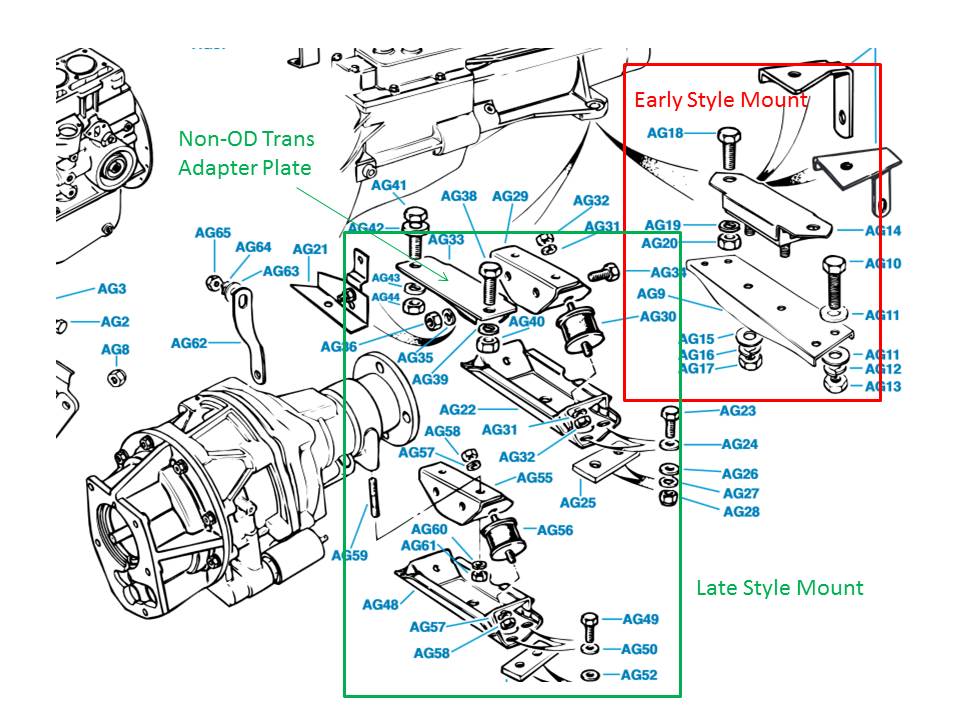

The gearbox extension/third motion shaft/tail shaft housing is the same as far as I know for all late TR-4/TR-5/TR-250/TR-6 non-OD transmissions. The change in the mount at the rear of the transmission for the later TR-6 cars was to accommodate the J Type overdrive. To use with an non-overdrive transmission, an adapter plate was bolted to the new style mount on the later cars. Bottom line is that as long as your transmission is properly mounted at the rear, it should work with an A Type overdrive. Please see the attached screenshot from TRF catalog with notes:

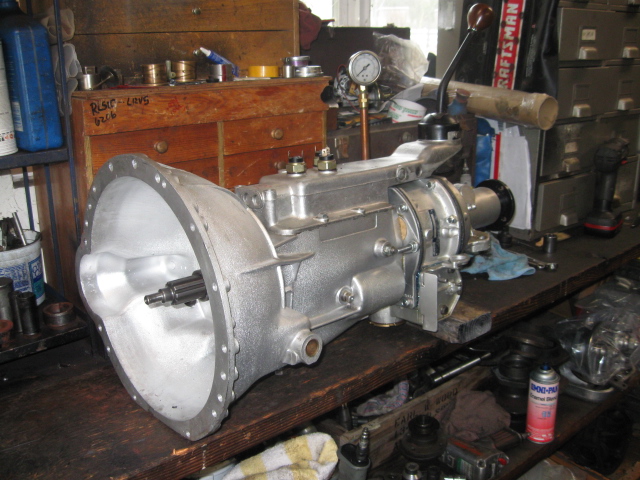

Curious about the pressure gauge shown in a photo in that thread: what range should it cover and how does it hook up?

what are the numbers on your overdrive,I will look up the pressure,also the gauge goes were the operating valve is
just toverdrive trans 001.JPGake the plug out,and screw the gauge in

360 psi for the large accumulator. 450 psi for small accumulator units used on IRS cars (the brass tag should have the #22/1753 or 22/1985. Identification can also be made by removing the sol. bracket and examining the springs-large accumulator will have 2 springs, small accumulator 1 spring.
