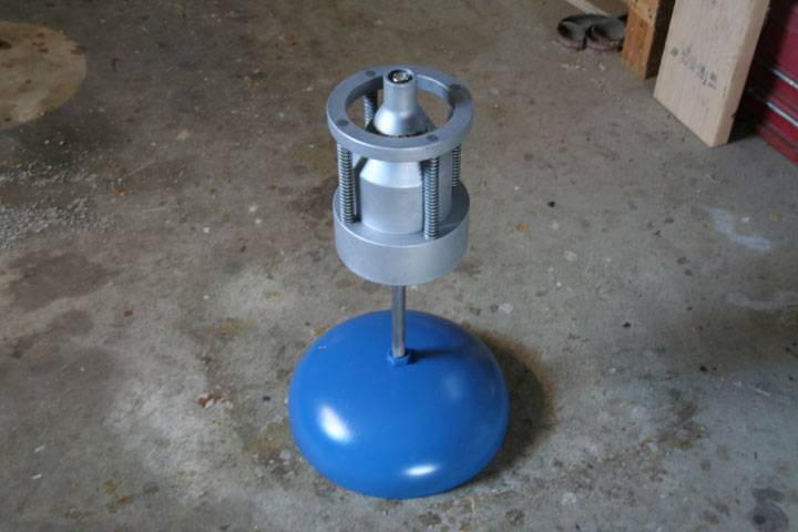

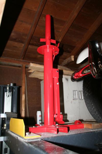

I know you are looking to have it done, but I bought new 60 spoke chromes for my TR3, and bought a HF mounting machine, 2 tire irons, and a bubble balancer. Did them myself for less money than having it done, and it worked out fine. My wheels are from MWS in UK, and haven't lost a bit of air in a year.
Geo Hahn
I also use the HF tire mounter and a bubble balancer. The tall sidewalls on our tires are pretty easy to get on the rims. For wires I remove the adapter hub for one wheel and mount it to the the tire mounter, keeps the wire rim secure without stressing or bending a spoke.
