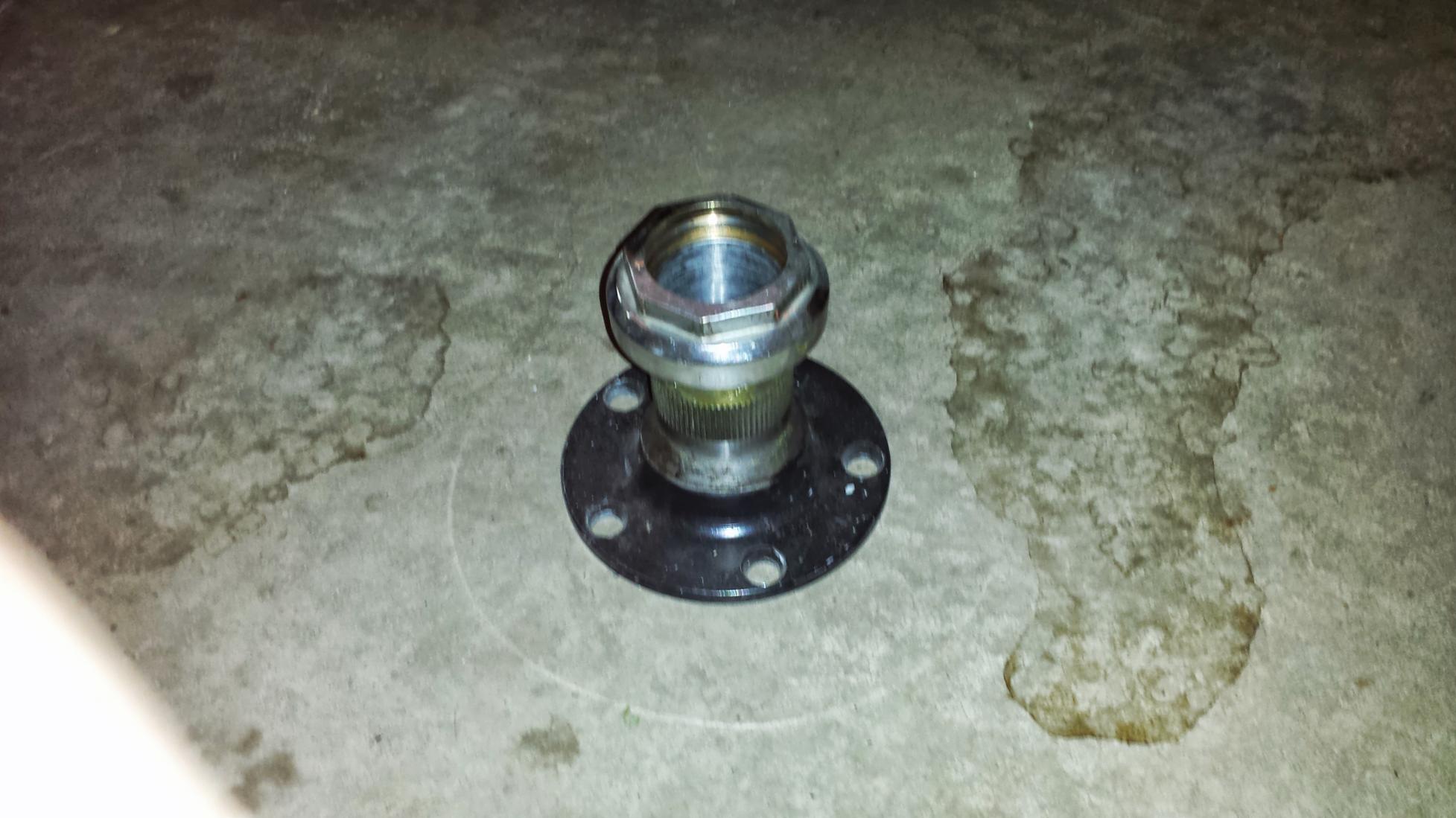

The other problem you may run in to is that some wire wheels won't fit on modern spin balance machines. I had to modify an old hub to use on the spin balancer to get this done. Basically, I just had a machine shop take out the center of octagonal knockoff nut and also machine the surfaces of the hub that sit on the spin balancer. It took a few trips between the tire shop and the machine shop to get it right, but fortunately both places were willing to work with me on it. Here's a blurry photo of it.

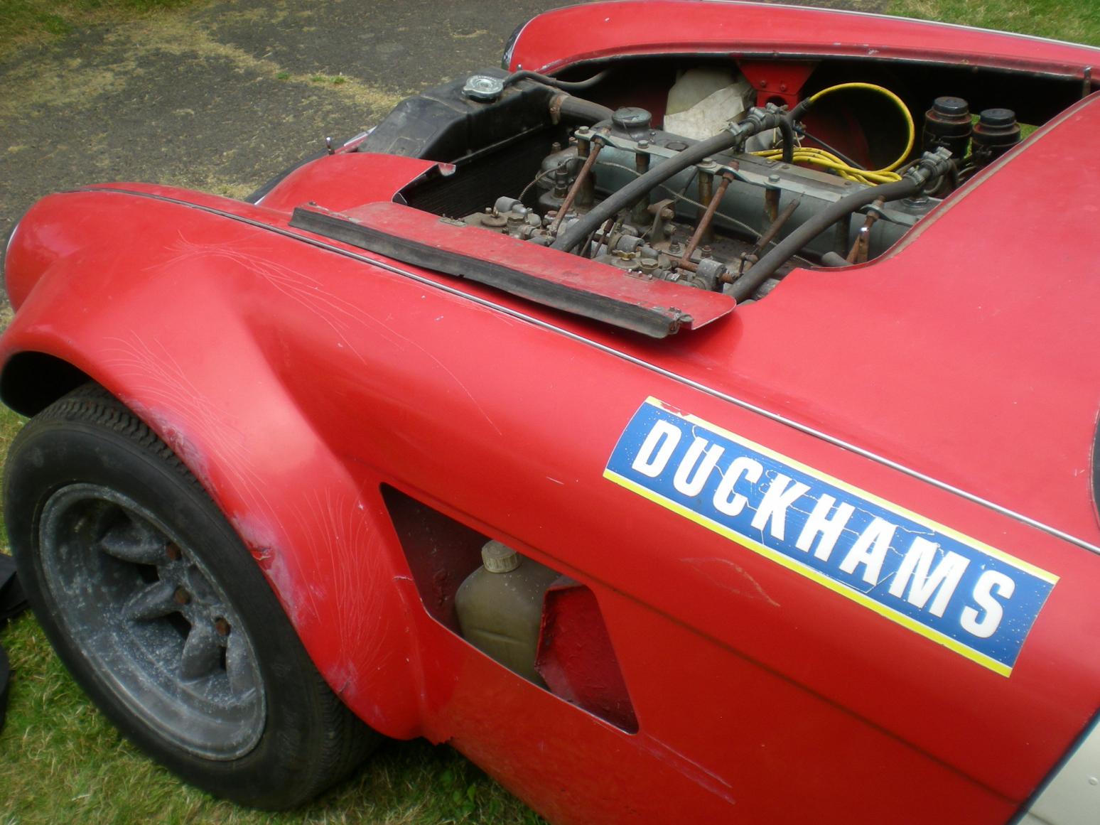

I'm partial to minilites as the practical choice, as others have mentioned they are more serviceable on road trips. And they look good too, as demonstrated in this pic of my favorite Healey.

Talk about a Healey I wouldn't want to meet at night in a dark alley:
Is that the old Syd Seagal car or is it something else?
ahealey1004
hi Rick- yes that's the ex-Syd Segal/ John Gott car known as ABL6, taken in Oregon @2010, when Bill Bolton still owned it. I believe Steve Pike now has it in Australia. I have been in love with this car ever since I first saw it in Bill's garage back in the 80's.

The Segal car was purchased by a Swedish chap who races it. It is no longer in the modsports format. The car raced at Castle Coombe in the all Healey race last year. I don't think the wheels on Syd's car were Minilites.
DerekJ
Here is a photo of the ex-Segal car at Castle Coombe and its wearing Minilites! The cars were allowed to race with Minilites as this race was not under FIA rules. In most of the big FIA Classic races such as Spa and Le Mans the cars have to run to FIA appendix K regs which means they must have wire wheels.
Didn't they use Wolfrace brand wheels? I can remember lots of coverage of those cars in Healey Highlights* back around the late 70s. In fact, the shop I was working at, Austin Healey West, used the Mod-Sports Healeys in their ad copy in HH issues.
