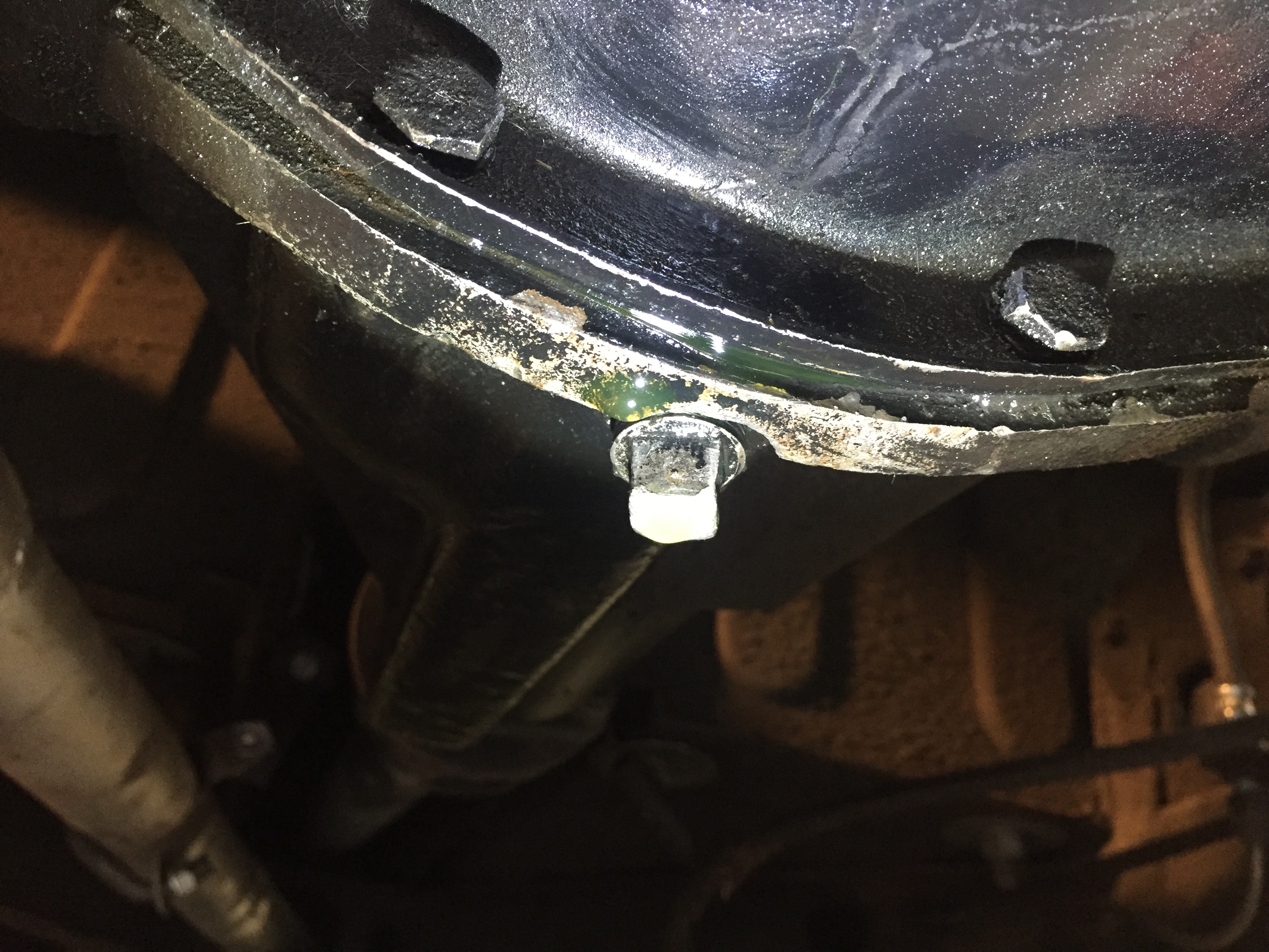

Hi All, I noticed that my rear diff is leaky and looking at it I was wondering how difficult it it to drain it, open in (6 bolts) replace gasket, cover back on and refill. Its seems pretty straight forward if Moss has the gaskets. Not guarenteed to fix the leak but couldn't hurt right? Am i missing anything - seems the brake line is kinda in the way but shouldn't pose too much issue I don't think.
Also if i get it opened, should i clean out the inside with any suggested solution before re-gasketing and closing back up? Thanks

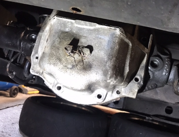

i think it’s the pressed metal diff cover you have, so worth running a straight edge (ruler, small spirit level, etc) on the tin cover facing edge. Especially around the hols and tap any flat that need it.

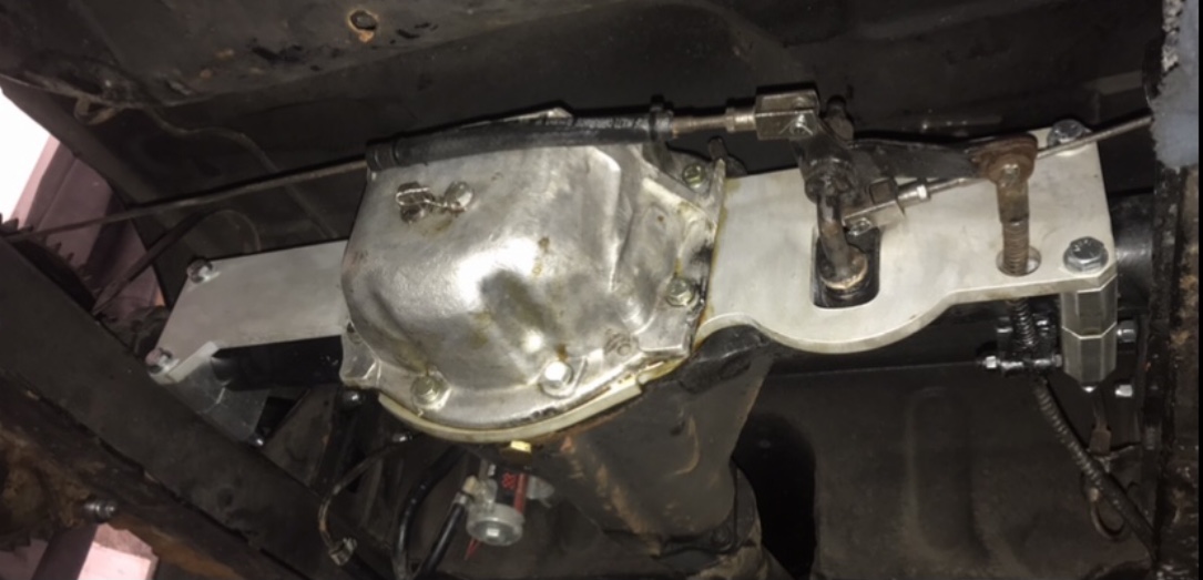

or upgrade to an ali one off a different model. This is my LSD version.
as for cleaning wipe out what you can reach at the bottom of the diff and the tin cover. You could use a spray brake cleaner and give it a good blast and let the stuff run out ? But it shouldn’t be too bad.
which this year I braced the axle tubes. But a step too far for you.

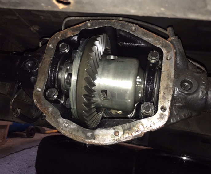

Speaking of which does anyone know the proper torque specs for the cover bolts? I'm not finding them in the manual but also I dont know the proper name which could be the problem.
They seemed not so tight when I pulled the cover off. Also there was no gasket at all. I have a gasket and rtv gasket goo. Also thread tape. Figuring this should solve the leak.
