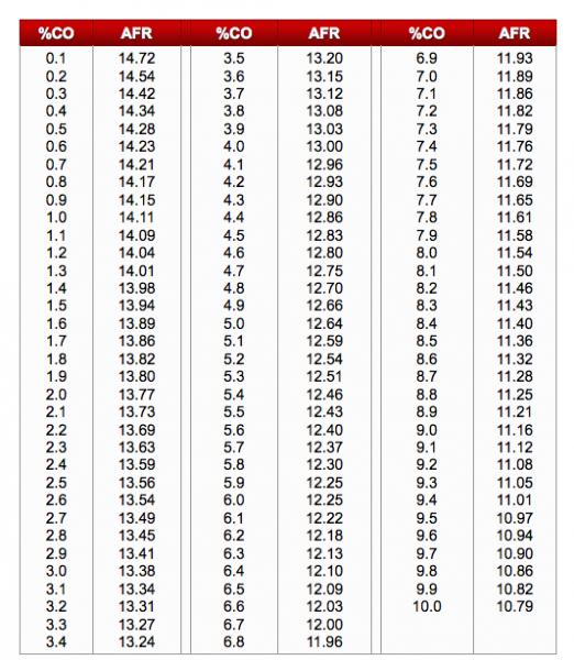

Searching around the web I found the attached table of air-fuel mixture (AFM)v CO%. Ideal combustion is at AFR 14.7 which equates to 0.1% CO. Most folk appear to settle on a CO 1-4%.
14.7 is ideal but you always want to be just a bit on the rich side to prevent detonation so optimal Air/Fuel readings would be 13.7 - 14.5.
