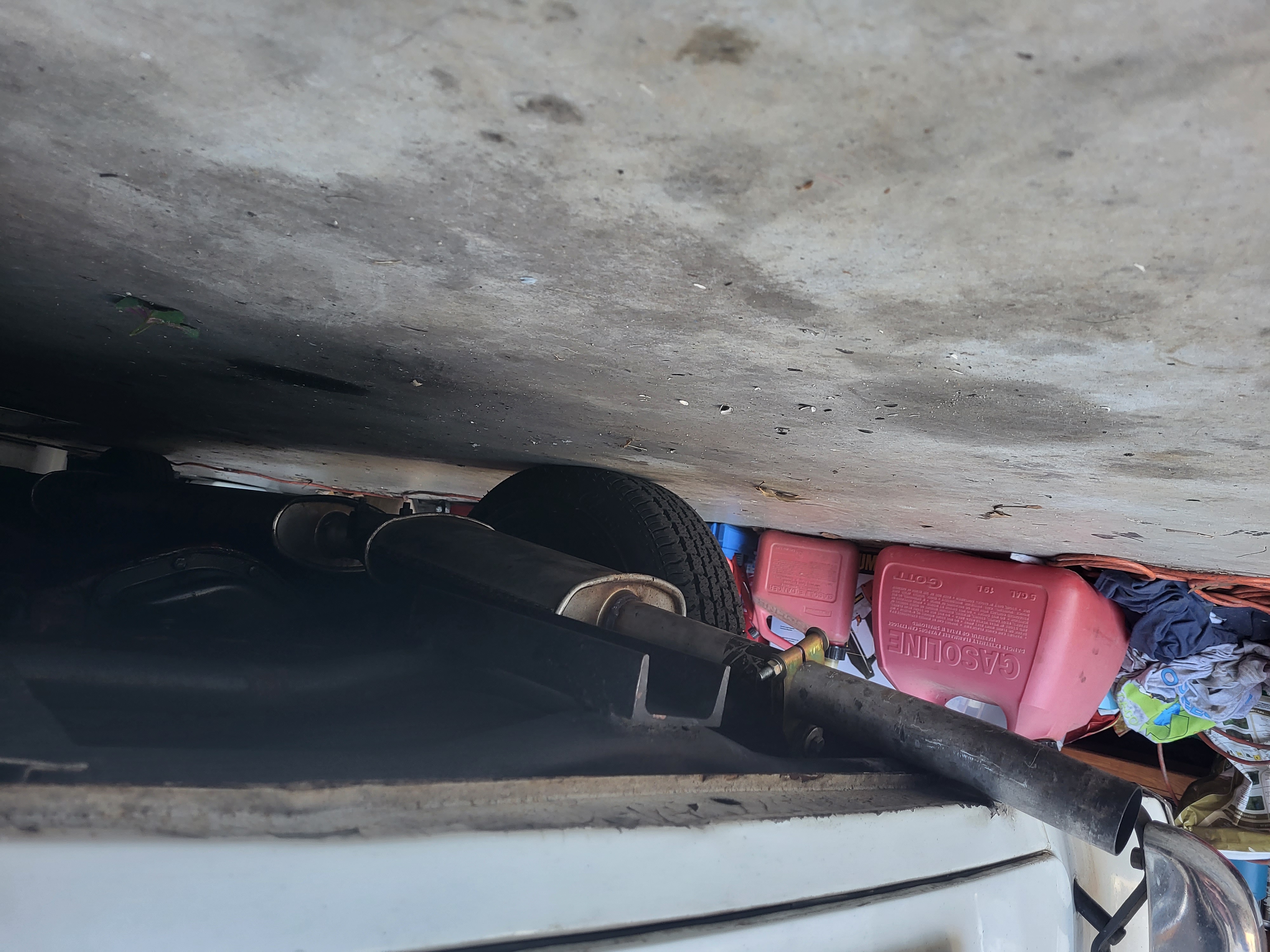

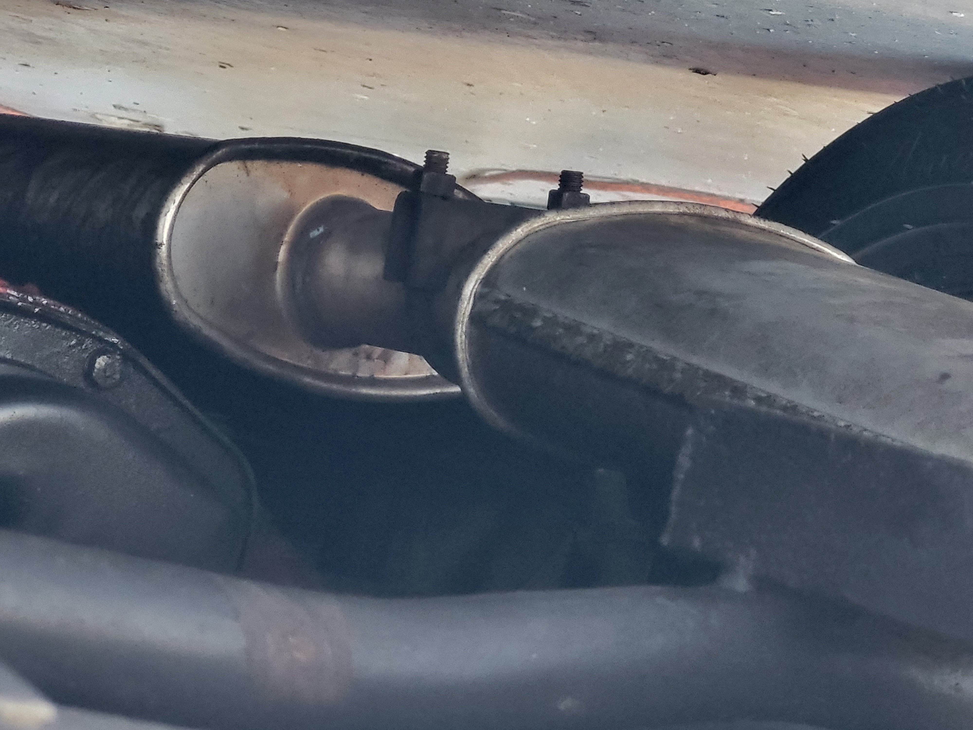

Sorry about my prolonged absence. I have attached 2 pictures. It seems like the front muffler is too long to easily fit between the box in the frame it passes through and the rear differential. I think I got it from Moss 15 years ago or so. There is a piece of angle iron welded to the frame which blocks the view of the exhaust system in the pictures, but it does not actually in the way.
Graham H
As Hamish said I would try and loosen that middle clamp and push the two mufflers up which should change the angle of the tailpipe and get it away from the body, it must be making some awful rattling noises back there?
