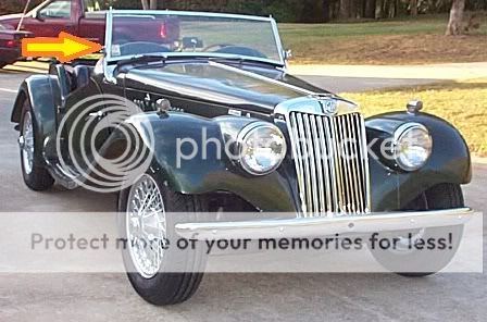

55 MGTF Bill. PJ
Photo when I got the car and before I stripped it down. Please ignore the arrow.
For a TF, 5" should work without looking overly wide......
