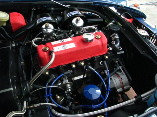

Correct, just make sure it's #1 piston! In the pic you can just make out where plug wires 1 and 3 go (counter clockwise).

Here's another one. Might help. Click on photo to expand. Sorry I don't have a larger shot. PJ
