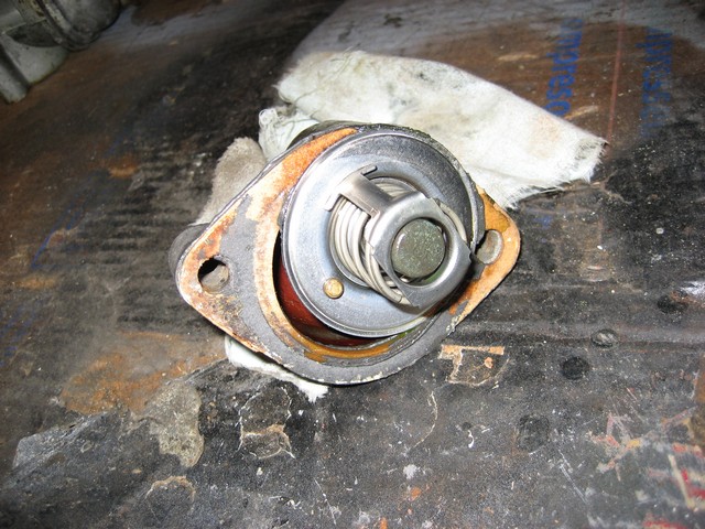

My situation with the thermostat was not a usual one. My thermostat had been installed poorly (it has slipped down when installed, I wish I knew how to attach a picture on this forum). That was a 160 t-stat and the car ran very poorly. When I replaced it with a (properly installed) 195 t-stat the car ran great. All this to serve as an extreme example of what engine temperature can do to engine performance. In the case of the poorly installed t-stat I had an extreemly cool running engine. Once I installed the t-stat correctly I had a proper temperature running engine.
Adrio
I think I have figured out the picture posting. This is what my t-stat looked like when I tool apart the housing to check it. As you can see a lot of coolant could flow past it therby allowing the engine to run way too cool.

Your lucky that the gasket sealed the housing and that the housing didn't crack because of the thermostat not being installed properly! /ubbthreads/images/graemlins/eek.gif

I was luck in so many ways on that one. though if the sealer had not been so thick I guess a leak would have happened and then I would have known there was something wrong. As it was I spent a lot of time trouble shooting carb and ignition problems that were not there. But as the man said, all is well that ends well. And I still have a spare housing so that is probably why it did not crack. had I have not had one it would have cracked right away. /ubbthreads/images/graemlins/lol.gif
