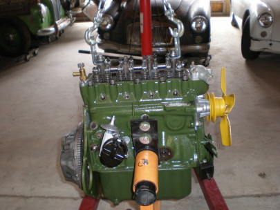

I am getting ready to install a Moss 5 speed conversion in our TF and I have a question. To do this kit I need to replace the motor mount and I was wondering what the best locations are to tie the lift chains to in order lift the engine with a crain.
Does anyone have pictures?

Like Dave said - those 2 bolts that hold the valve cover on car are where I lift all my engines...the 2 little adapters I use are just a metal "L" with holes for the stud & a chain.

Looking at the valve cover bolts I thought they were a little small but from everything I have seen that is what it seems we use.
