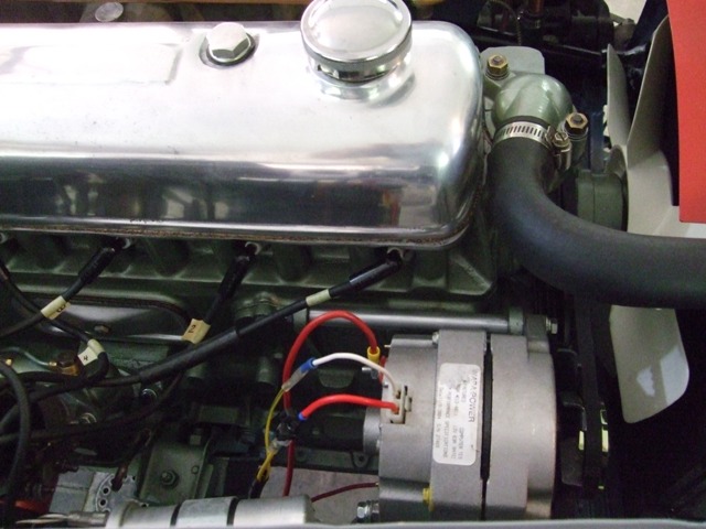

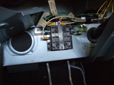

Absolutely make the change. The possibilities are endlesss. I've got negative ground, alternator, two fuse blocks, auxilary driving lights, two separate power jacks for GPS, Cell Phone or I-pad. Never looked back and no electrical problems. I believe I got my bracket from Allen Hendrix of Hendrix Wire Wheel. He's a great help.
