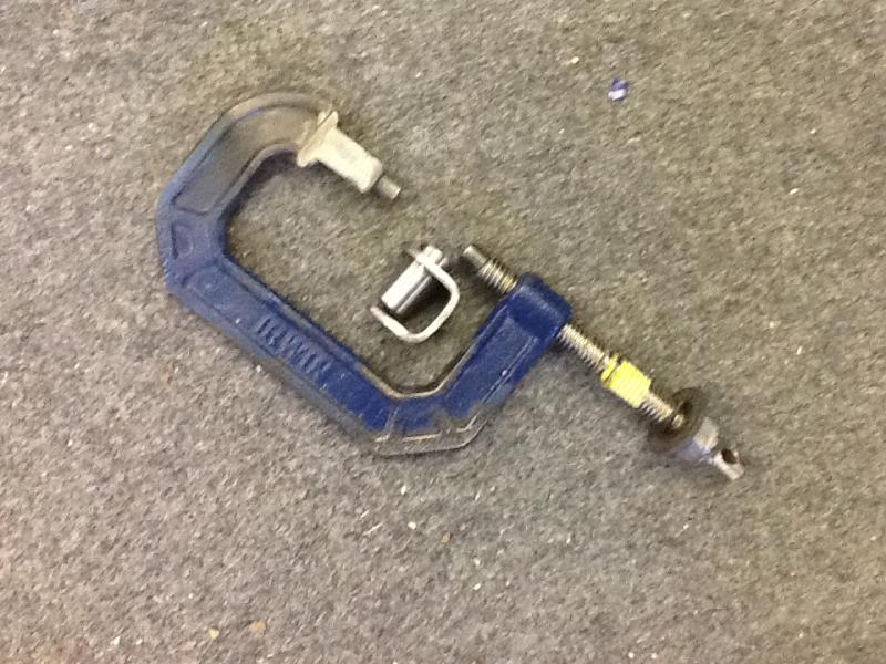

I built my tool from a C-clamp and two rivet setters for semi-circular rivets. I shortened the rivet setters and welded them into the clamp. I got the idea from a youtube video by Matthew Randell.
But you should take a more robust C-clamp. at the 12 rivet it is broken at overload. I welded them together again and strengthened a bit
