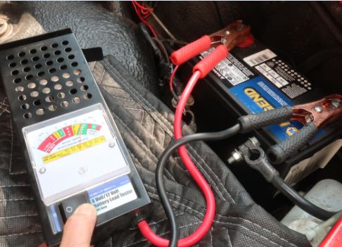

I have re-built the H4's for the 2nd time, with the new o-rings in place of the cork gaskets.My battery is 3 years old, but has never been used and has been on the small triple charger most of the time. After using my other charger, over night, it still wouldn't turn it over enough to start it? Will take it to Advance Auto tomorrow to see if it is still good.

Sarastro
Do you have a load tester? Not particularly expensive, and it's the gold standard for evaluating batteries.
I agree, you need to get it cranking properly first. Then, if it cranks well but still won't start, worry about carbs and ignition.
R
Redoakboo
I took the battery into Advance Auto, where I bought it three years ago. They did a load test and the battery is bad. I came home with a new one and will try to start it again tomorrow.

CJD
I had a couple years when I put every vehicle I owned on trickle chargers (6 cars, 2 boats and an RV). All those batteries went bad by the end of the year. Don't know if it was the cheap Walmart chargers or not, but I no longer leave any vehicles on chargers any more. I now make it a point to start every vehicle and charge the batteries once every 4-6 weeks. Now my batteries are all lasting 5+ years. It's a win-win as every vehicle needs to be exercised or systems start acting up...switches corrode and seals dry out.
Madflyer
I used to get Interstate battery's Just because they were green as is my TR. DUMB. at two years old they were dead every time went to start up dead. Battery tender OK but did not last any longer. I went to a DRY CELL battery and tender now almost 7 years with a new geared starter starts every time. When you check a battery volt mean little it's amps that what the load test does. Madflyer
