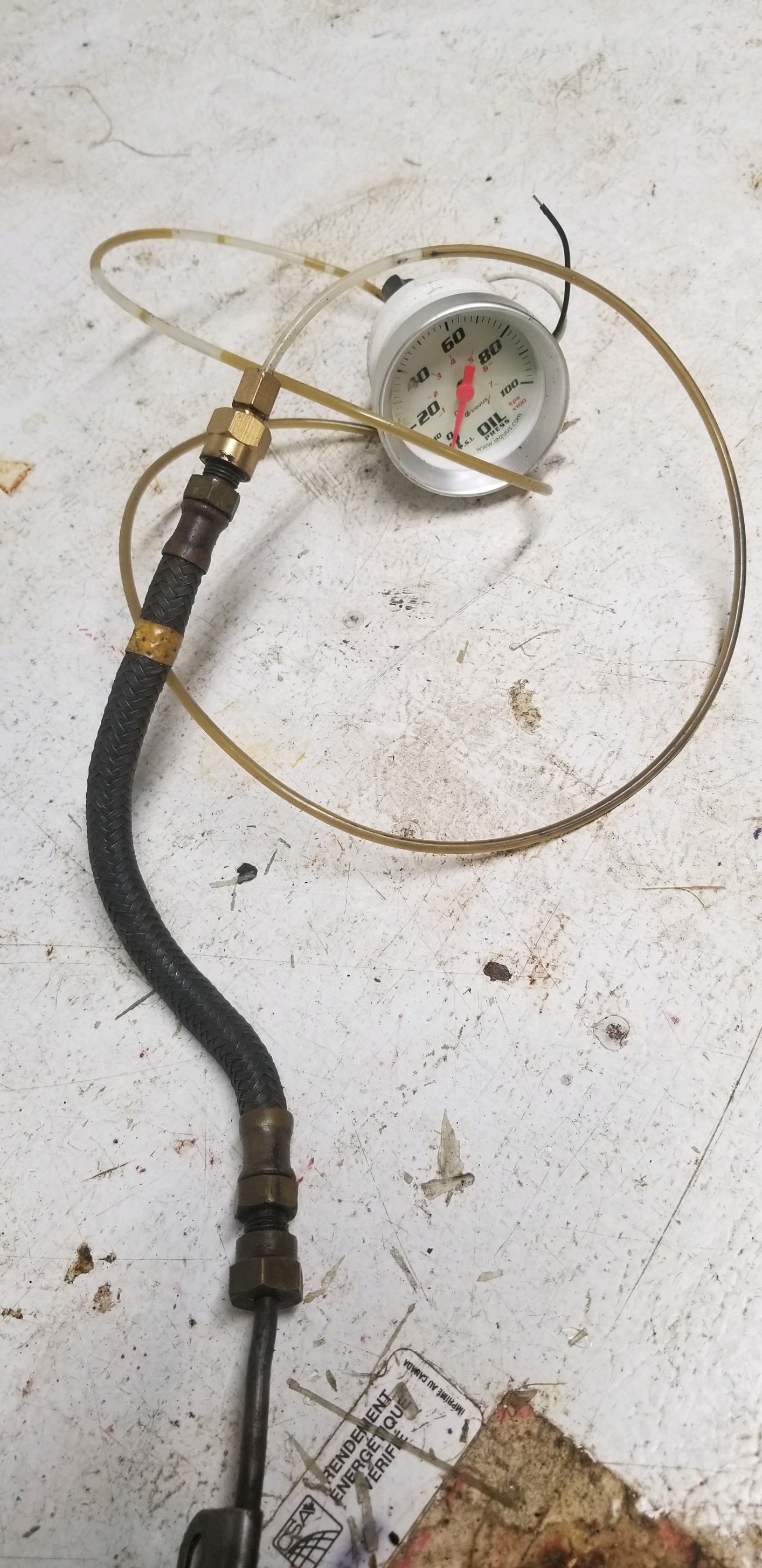

DavidApp
You could get a cheap oil pressure gauge from one of the local parts stores and connect it at the connection by the battery. That will give you a second opinion on oil pressure.

Is this an easy connection to make or do I have to connect with special fittings?

As far as I remember the line screwed on where the copper line connects to the flexible hose at the rear of the engine. Checking my spare parts it just screws on the flexible hose.
David
