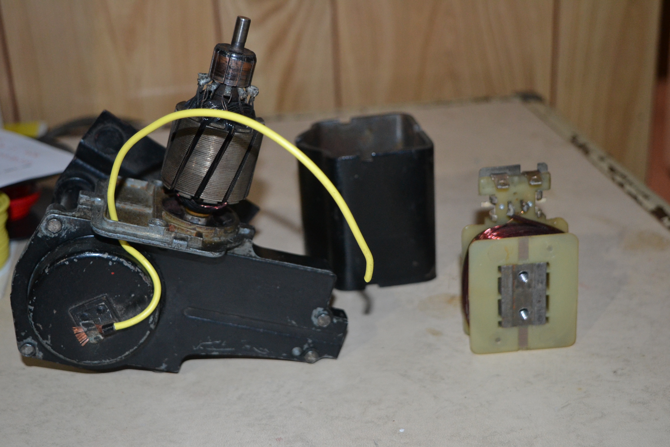

I am trying to find where the yellow wire in the picture connects.

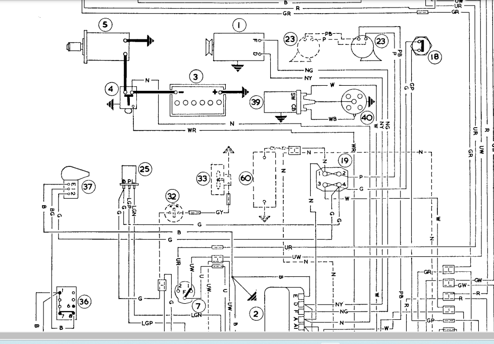

I don't think I have a problem in connecting the #1, #2, and E connections as shown on the attached diagram and (as yet) have not found a wiring diagram showing it.
I have looked at quite a few pictures that I had googled but could not see where/what the wire is attached to.
I have had comments that the yellow wire goes here or there but I believe I had used the yellow because it was what I had on hand rather than any attempt to follow the colour codes.
Thanks for any responses.

The wiring diagram looks right for the DR2 motor. And I think you did supply the yellow wire.Its purpose is one side of the park switch or limit switch as Lucas calls it. Bad part is I can't say for sure which side, hot or earth. In either case though, I'm pretty sure it is an internal connection. Those wires in the diagram, 1, 2 and E are the only external connections on that motor. I'll try to check mine tomorrow to verify that it does go internal but I won't be able to tell where it connects.

thanks very much for the reply, another forum indicated it is attached on the inside to the # 1 connection....
