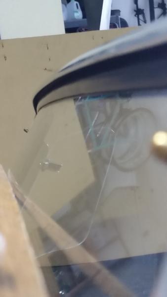

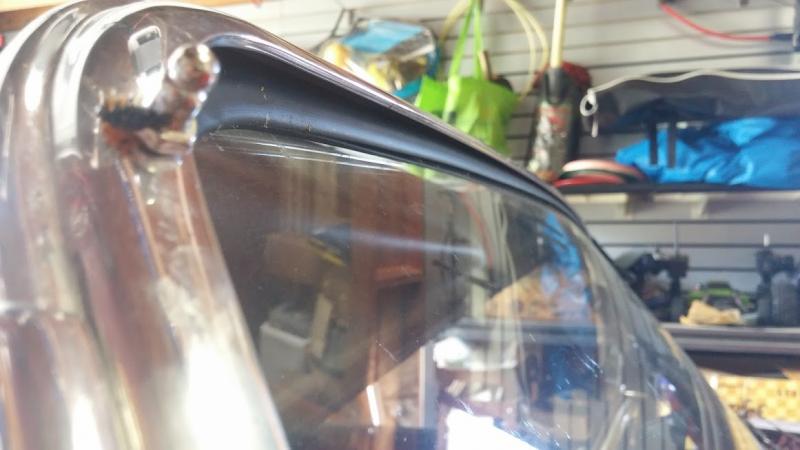

Its seems my windscreen frame has been bent in, not allowing the top bar to fit into it and pops out. I've been brainstorming how to bend it out without messing up the glass, and how to bend it out so its consistent with no high and lows. Thoughts?
nomad
Wow, that's a mystery! I think I would try a pipe clamp corner to corner close to where the lift the dot studs are. What ever you do, do it carefully or you could end up needing a new windshield.

The glass is replacement, don't know the supplier. Any chance the arc differs from original glass? The frame is in quite nice condition, can't see it being bent. Would love to find original glass to put in the car anyhow.

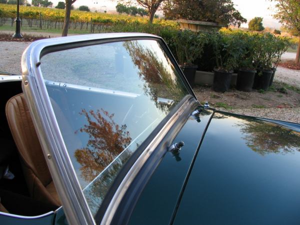

It is curved.....I'd love to see other people's pics from a similar view to see the arc of other windshields.
Edd,
I pulled these 2 off the internet...

whoa! wonder what my glass is from? How odd, thanks Rut!

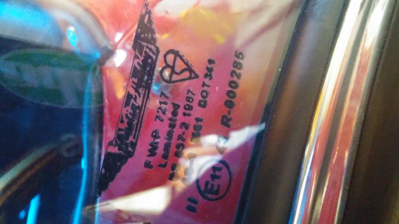

Just snapped this pic, couldn't find any of these numbers online, but it is stamped 1967. Have no idea what that is in reference to. MKIII?

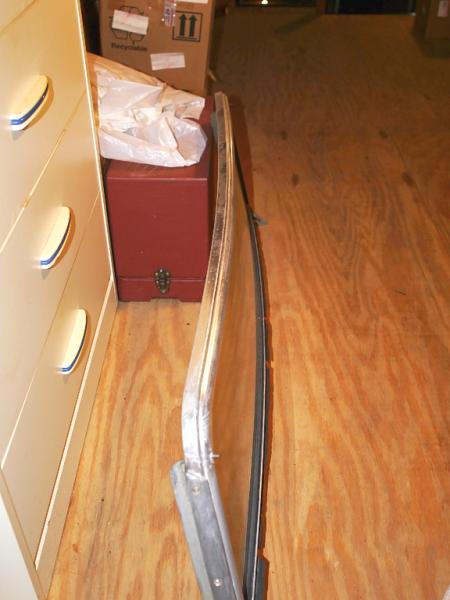

I just got home and measured mine with a 4' straight edge and it does curve in about an inch on each side when the straightedge is held in the middle. Along the top the straight edge misses the studs in each upper corner about 1/16"...sorry for the misinformation!
