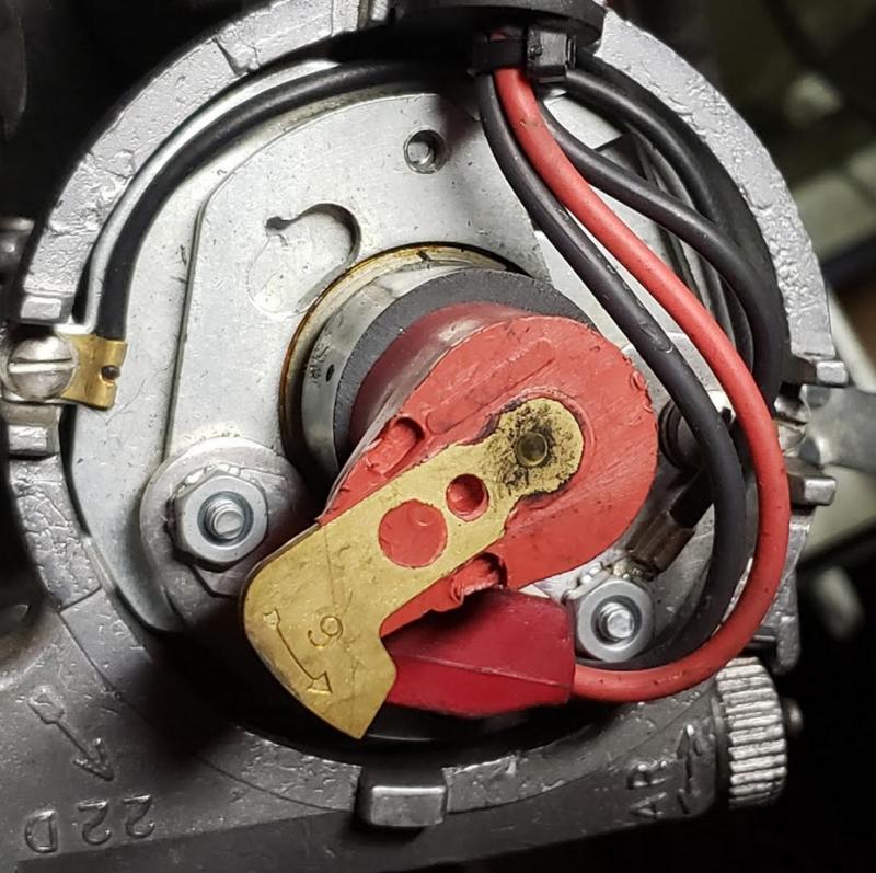

Still no love.
I switched out the pertronix, coil, and when i crank it theres still no spark. I swapped both fuese's just in case, took a multi-meter to the coil and with the key in the on position, i dont get a reading. Any ideas?
I've used Richards wiring diagram and it looks like the coil directly connects to the switch, so do i test from the switch to see if i might have smoked the wire?

So I pulled the coil wire and see 12v coming through, and I pulled the graphite piece and indeed got continuity through the wire in the cap... and still no spark...
If your car is positive ground you're SOL for an Ignitor II:
"Hello Bob. Unfortunately, we do not make an Ignitor II with positive ground for your application(*). We will not develop this anytime soon per our Engineer. PLEASE LOG BACK INTO TICKET SYSTEM TO REPLY DO NOT PRESS REPLY ON NOTIFICATION EMAIL Thank you.
Your Pertronix Team,
Elvis Duenas
Technical Advisor"
*BJ8 with positive ground.
John Turney
If you hold the cap end of the high voltage wire ~1/4” from a ground, and crank the engine, do you get a spark? BTW, I use a wooden paint stirrer with a hole in it to hold the wire instead of letting it bite me.
dklawson
At the coil, remove the high-tension lead going to the distributor cap.
Remove the spark plug wire and plug for cylinder #1 from the engine and from the dizzy cap.
Plug that wire into the center terminal of the coil, seat the spark plug in the other end of the wire, then rest the plug on the cylinder head. (I prefer this to holding the wire next to the head as suggested above. I've been bitten too many times).
Now have someone crank the engine while you watch for a spark at the plug resting on the head.
If you do see the plug sparking, that says the coil and module are working. That means the problem is in either the rotor, cap, or main high-tension lead lead.
If you do not see a spark there are a few potential problems to check for...
Did you remember to fit the Pertronix magnet ring under the rotor?
With the wires removed does the coil still have about 3 Ohms across its low-tension terminals?
Is there a ground wire present between the breaker plate and the dizzy housing?
BTW, Steve G. and I have been told different values for the Pertronix overheat time. He was told 45 seconds, I was told 3 minutes, others I know have been told 5 minutes. Regardless, it's a known problem. Whenever I need to work on something that requires leaving the ignition on I unplug the Pertronix red wire first.

Hi Bob, nope, neg ground, took care of that long ago... Thanks for the note!
Let me give it a try and will post back, thanks John!
