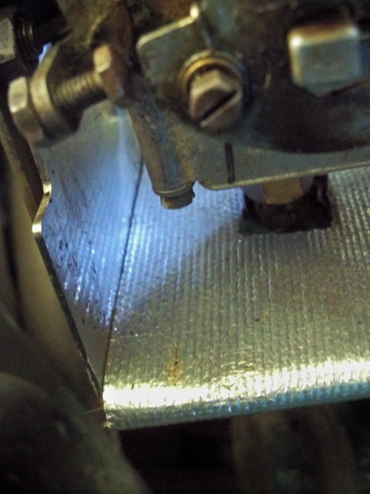

I'm only familiar with 2 and both are made by ARE and sold by Moss if not direct.
But in my experience it did not work 'naked'.,,but once I added real heat insulation to the floor, no more percolation issues.

Update - I purchased a heat shield to keep the ZS float bowl cool. I also added a couple layers of insulating material to the heat shield per Ken's suggestion. I still am experiencing the same problem with the car not starting once it warms up. The last time this happened I had only driven the car a mile or so down the road and it was a cool day out.
